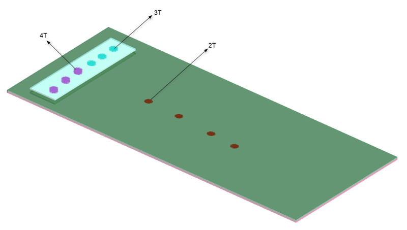

Note: Welds are only found within a tolerance of the spot weld diameter. So, for a 5mm weld, the XYZ values must be within 5mm of the part surfaces.Tip: The 2T, 3T, and 4T spot welds can be visualized in different colors. Right-click on the spot welds in the Project Tree and click Show All. The 2T spot welds are highlighted in red, 3T in cyan, and 4T in pink.
