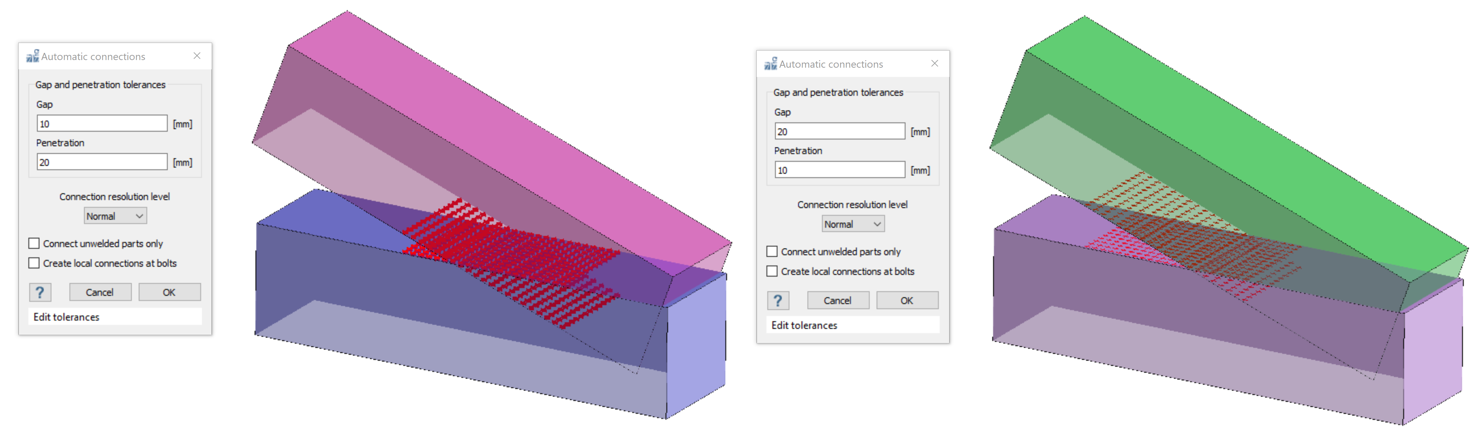

- Tolerances
- Connections are established based on proximity criteria. If two parts have faces within the defined gap/penetration tolerance window, a connection can be established between them.
- Gap tolerance:
- Too Large: A large gap tolerance can result in connections being made in undesired areas, potentially leading to an over-stiff model and unrealistic simulation results.
- Too Small: A very small gap or penetration tolerance can result in parts remaining disconnected or unstable, affecting the accuracy and reliability of the analysis.

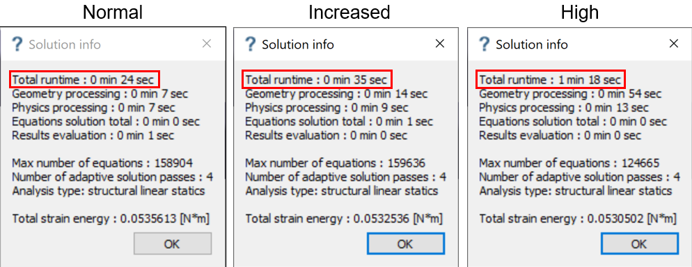

- Resolution

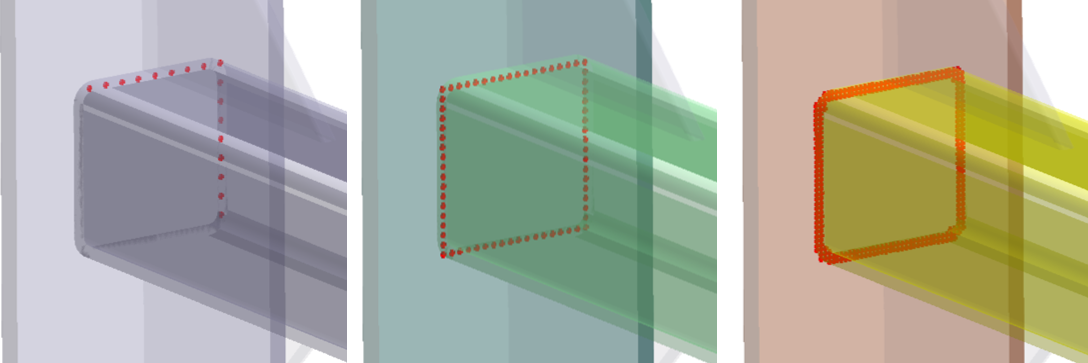

- The density of the point cloud at the connection interface indicates the
strength and quality of the connection. A higher number of points
ensures a well-defined connection between parts, which is crucial for
predicting accurate load paths, avoiding stress concentrations, and
resolving convergence issues in non-linear contact analysis.
- Selective Use: Only use Increased, High,
or Extreme resolution in areas where detailed connection
definition is necessary. This prevents unnecessary computational
overhead.
- Aspect Ratio Check: Use the Aspect Ratio option in the review connections window to assess connection quality. A connection with an aspect ratio less than 0.001 is considered well-defined.
- Connection Layers: Ensure there are at least two layers (lines) of connection points between the parts to provide a robust connection.

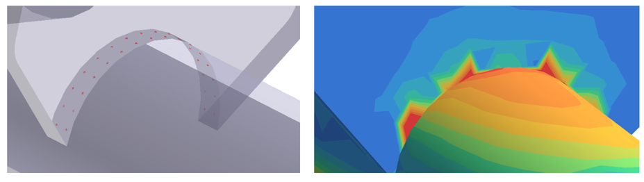

- Avoid Discrete Points: Ensure that
connections do not contain discrete points, as these can lead to
stress concentrations and inaccuracies in the analysis.

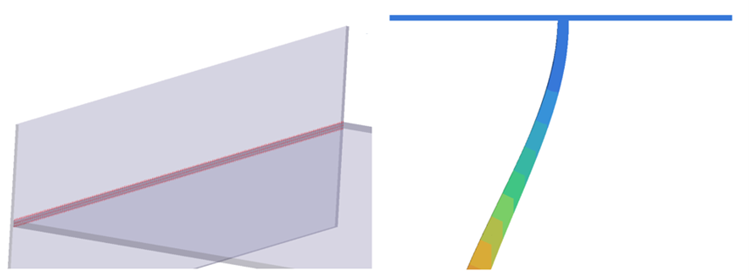

the assembly, affecting its overall performance.The below figures is a model with two plates connected by a single layer of connection points. When analyzing this setup, it can be observed from the image that the vertical plate behaves as if it is hinging around the connection line.
Figure 4.

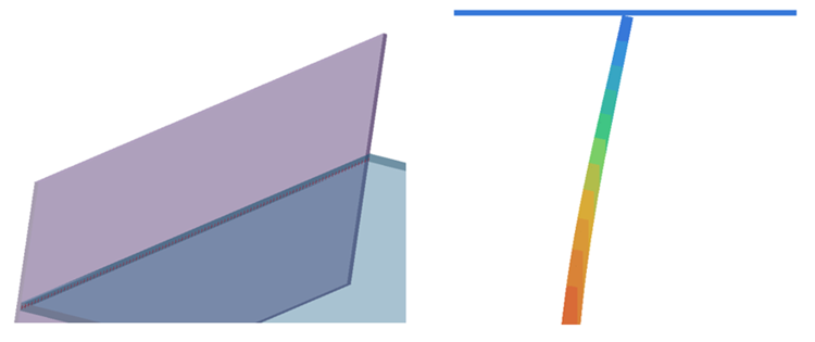

In such cases, it is advisable to increase the connection resolution. As shown in the image, increasing the resolution adds multiple lines of connection points, which results in a more robust bonded contact along these points during the analysis.Figure 5.

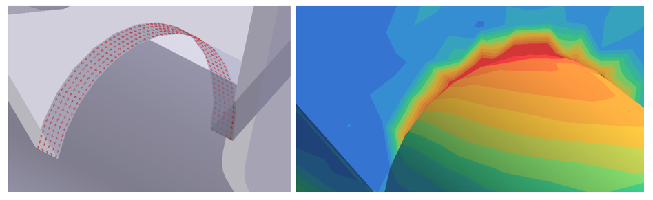

- Unwanted Stress Concentrations: Inadequate point
cloud density or poorly defined connections can lead to localized stress
concentrations, which are unrealistic and may not reflect the actual
behavior of the assembly.In the example below, the first figure illustrates localized stress concentrations due to inadequate connection points. However, the second figure features a higher density of connection points which displays a more even distribution of stress.
Figure 6. Inadequate connection point cloud
Figure 7. Adequate connection point cloud

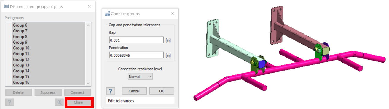

- Show Disconnected Groups:
- Lists all disconnected groups of parts, allowing you to either delete, suppress, or connect them.
- Select the disconnected groups you want to address and use the
Connect option to establish connections without
having to recreate other connections.
Figure 8.

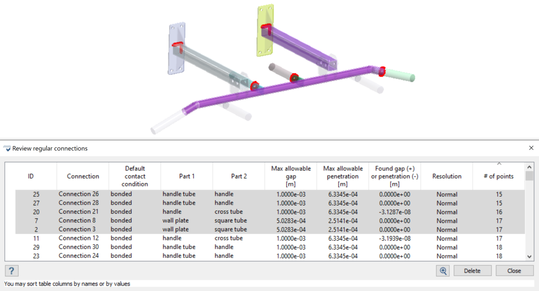

- Review Regular Connections:
- Provides a comprehensive list of all regular connections within the design study, including detailed information on each connection.
- Use this tool to sort connections by gap/penetration, number of points or aspect ratio to identify and address problematic connections.
- The aspect ratio option in the review connections window helps
evaluate the quality of connections. Connections with an aspect
ratio less than 0.001 are considered well-defined and ensure good
connectivity between parts.
Figure 9.
