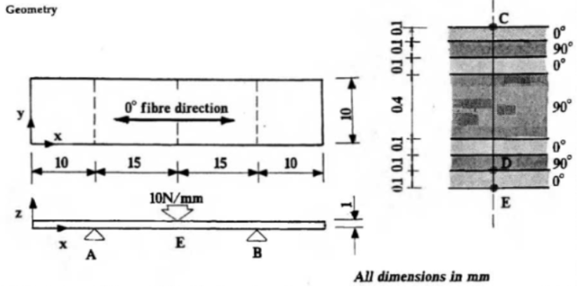

Test No. VC01Find the deflection, bending and shear
stresses in a simply supported laminated strip.
Definition
The material properties are:
- Properties
- Value
- 1e5 MPa
- 5e3 MPa
- 0.4
- 0.3
- 2e3 MPa
- 2e3 MPa
Boundary Conditions
- One quarter of the beam is modeled
- Sliding constraints are applied at X=25mm and Y=5mm
- Displacement in Y and Z are set to 0 at A
- Load of 25 N is applied on the edge at E
