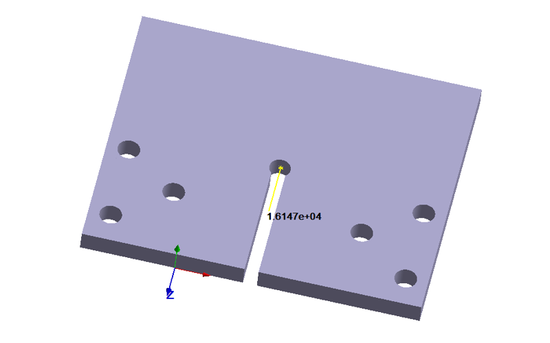

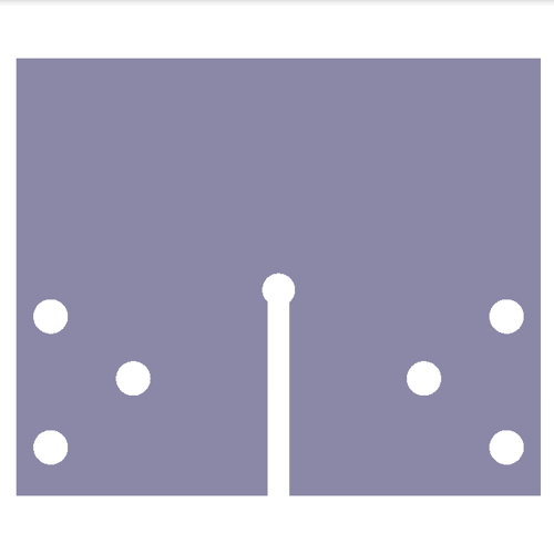

Test specimen is subjected to tensile loading of 1000N at circular holes. Signed von
Mises combined stress is used. The loading from structural analysis variation over
time is shown in the table below.

| Coordinates | Reference1 | SimSolid | |
| Point 1 | [33.451,4.1929,-64.493] | 16200 | 16146.7 |
