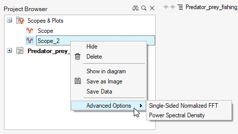

From the Project Browser, right-click the scope block name and select from the
following options on the context menu:
Option Description Shows/Hide Shows/hides the plot that has been created. Delete Deletes the plot window, not the Scope block. Show in Diagram Highlights the selected block in the diagram.

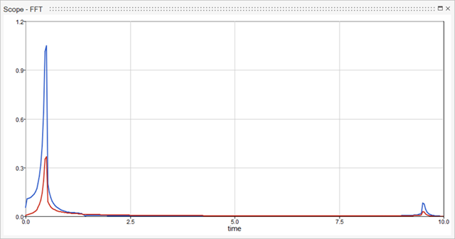

Save as Image Saves the plot as an image .png or .bmp file. Save Data Saves the data that is displayed in the plot as a .csv or .mat file. This option works for plots with and without subplots. Displays data in a frequency domain for the Scope block. Select the Single-Sided Normalized FFT or Power Spectral Density option, then enter a sampling frequency in the Input Dialog.
A new window is generated with a frequency-domain plot and is named based on the primary scope window followed by FFT or PSD.
