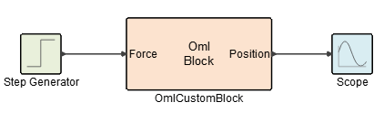

Drag an OML Custom Block, Step Generator and Scope block into your model
diagram:
Assemble your diagram:

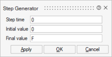

Define the Step Generator
- Double-click the Step Generator block.
For Final value, enter F, which is the Force.
- Keep the default values for the Step time and Initial value.

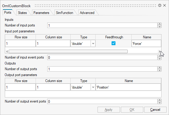

- Double-click the Oml Custom Block in your model.
Select the Ports tab.
- For Number of input ports, enter 1 and name it Force.
- Select the Feedthrough option, which specifies that the system input directly affects the output.
- Enter 1 output port and name it Position.
- Keep the defaults for the remaining fields.

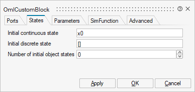

Select the States tab:
- For the Initial continuous state, enter x0.

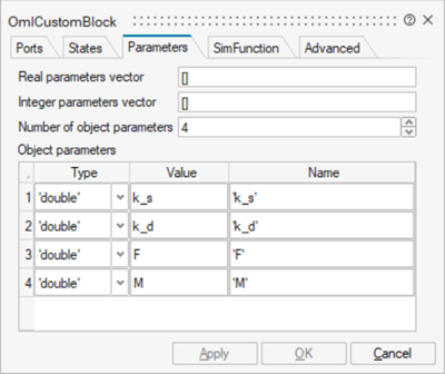

Select the Parameters tab:
For Number of object parameters, enter 4 and define them as follows:

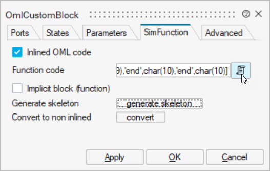

Define the Sim Function
- Select the SimFunction tab.

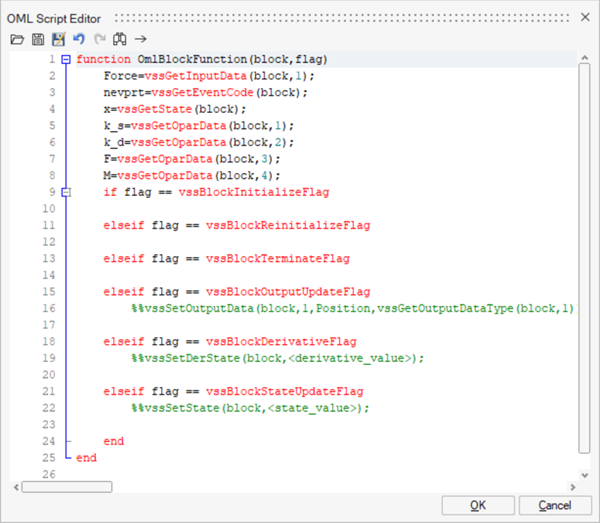

Click the generate skeleton button, then click the text
editor button.
The software generates a code skeleton with the appropriate flag options based on the information you defined in the simulation function and diagram context. You utilize the flags that you want to include and ignore the flags that are not required for your model.Note: The structure of the skeleton that is generated is the same for different custom blocks, such as CCustomBlock and PyCustomBlock, respecting the syntax of each programming language that is deployed.

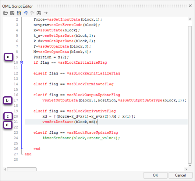

To complete the simulation function for the spring damper, modify the code in 4
places as you see in the following image:
- Line 9, add:
Position = x(2);
- Line 17, uncomment:
vssSetOutputData (block,1, Position, vssGetOutputDataType (block,1));
- Line 20, add the equation of motion:
xd = [(Force-k_d*x(1)-k_s*x(2))/M ; x(1)];
- Line 21, uncomment
and modify <derivative value> to reference the drivative state variable:vssSetDerState(block,<derivative value>);
vssSetDerState(block,xd);
Your new script should look like this:
- Line 9, add:
Click OK.

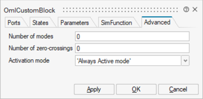

- Select the Advanced tab.
For Activation mode, select Always Active mode, which
specifies that the block is dependent on time and will be called continuously at
each step of the simulation.
Click OK.

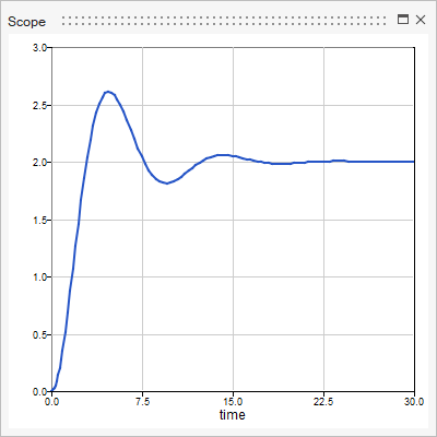

When the simulation finishes running, double-click the
Scope block.
The scope shows the signal output from the OML Custom Block as Position vs. Time.
