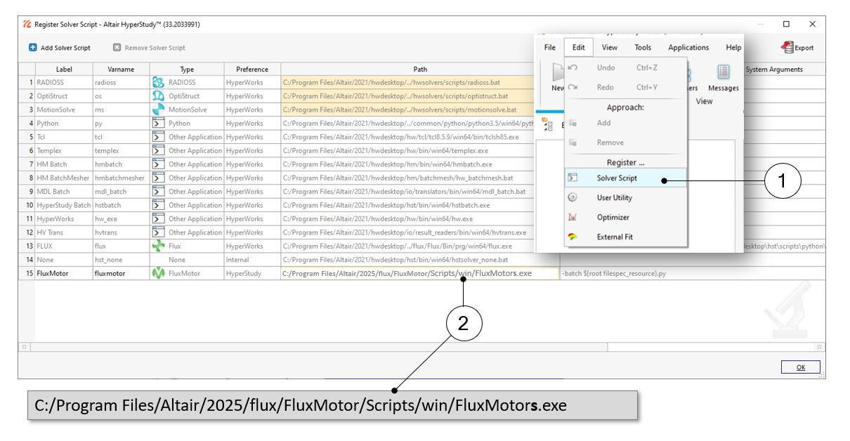

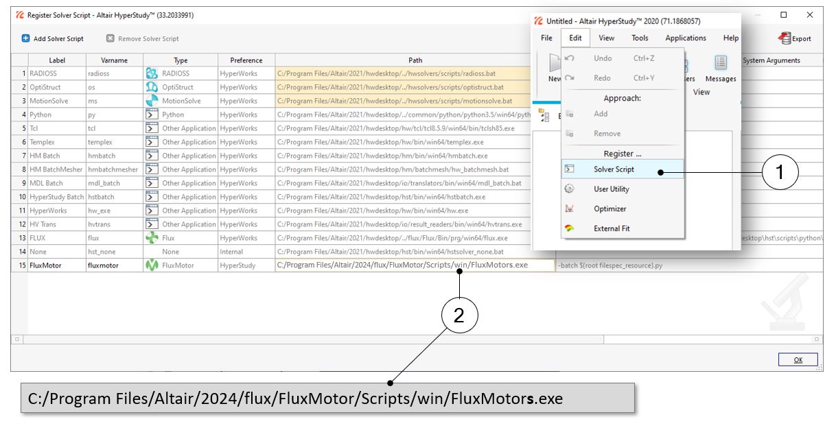

Before starting new studies in Altair® HyperStudy® by using connectors exported from Altair® FluxMotor®, FluxMotor® must be registered as a new solver script in HyperStudy®. This must be defined only while using the coupling for the first time.
| Connection between Altair® FluxMotor® and Altair® HyperStudy® | |
| 1 | Open the area in HyperStudy® to register FluxMotor® 2024 script |
| 2 | Path where FluxMotors.exe must be selected to be registered as a
new solver in HyperStudy®. Note: FluxMotors.exe with an “s” at the end of FluxMotors. This must be defined only when using the coupling for the first time. |

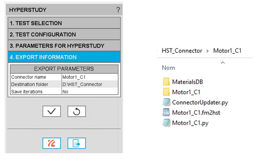

Open the FluxMotor project (example Motor1) with the version FluxMotor 2022.3
- Select the test to be performed.
- Select the test configuration.
- Select the parameters for HyperStudy
- Define the Export information: Connector name: Motor1_C1, for example, and the destination folder
- Then, export the connector.
| Generation of a connector for HyperStudy from Motor Factory Export- HyperStudy area. |

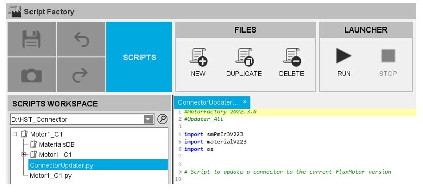

Since FluxMotor 2023 version, a solution exists to update the connector and make it compatible with a more recent FluxMotor Solver Script. This consists of running the ConnectorUpdater.py file which is provided and located in the same folder as the connector. This allows us to update the connector and make it usable with a newer version of the FluxMotor solver.
To apply this new process, one must open FluxMotor 2023 and get into Script Factory. Then, in the Script Workspace, one must select the folder in which the previous connector is stored.
| Edit and run the ConnectorUpdater.py file from the Script Factory application |
It is mandatory to run the ConnectorUpdater.py file in the folder where the Connector to be updated is located (the default location) otherwise the updating process will fail.
The ConnectorUpdater.py file must remain in the same folder as the connector to be updated.
A new folder containing the previous connector is then built at the same level as the former folder.
Its name is the same with the additional following extension: “_updated”.
| Resulting updated folder while running the ConnectorUpdater.py file |
