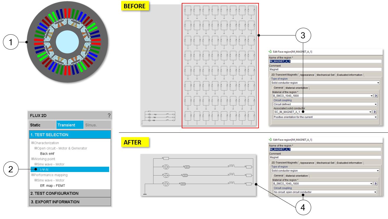

A more effective way for considering the magnets in electrical circuit (SMPM machines)
The electric circuit of magnets in SMPM is removed from the Flux project of all transient exports and the Flux project of backend computation in FluxMotor, resulting in faster export to Flux and faster preparation for tests in FluxMotor. Joule losses within the magnet are still calculated with the same level of accuracy as before.
| A comparison between how magnets are considered in transient exports of SMPM in Flux | |
| 1 | A SMPM with multiple magnets is selected. |
| 2 | Choose a transient export from the list |
| 3 | Before FluxMotor 2024, all magnets were assigned electric circuits for the Joule loss computation in magnets |
| 4 | From FluxMotor 2024, Joule losses of magnet are computed with no need for the representation of electric circuit of magnets |
