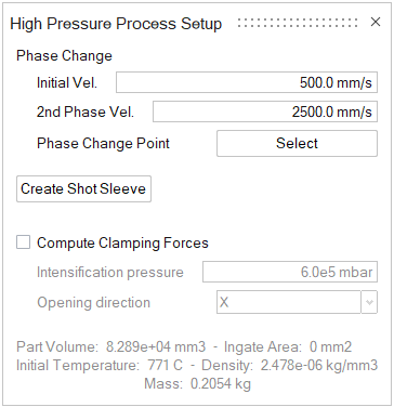

High Pressure Options
- Without Shot Sleeve
- When no shot sleeve is included in the model, the High
Pressure Process Setup window includes these controls:
- Initial Velocity (m/s)
- Typical values for Initial Velocity are 0.2–0.5 m/s.
- Second Phase Velocity (m/s)
- Typical values for Second Phase Velocity are 2.0–5.0 m/s.

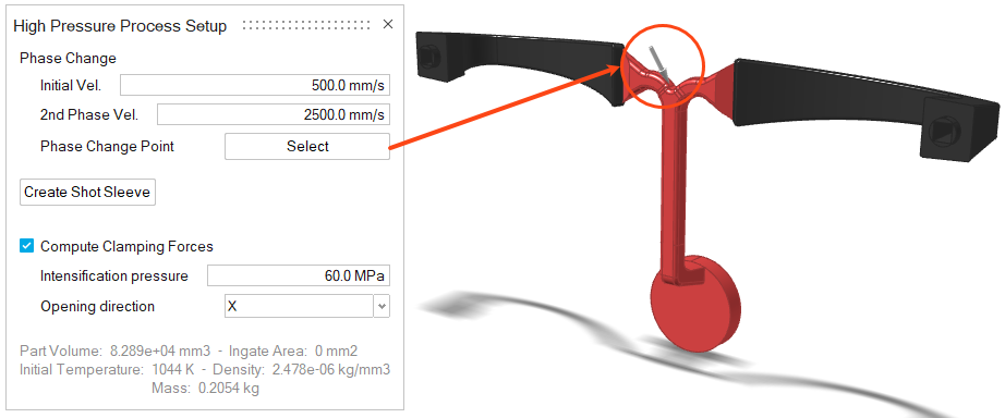

- Phase Change Point
- To specify where the initial velocity changes to the second
phase velocity, click Select, and
then click a point on the runner.Tip: The phase change point needs to be on the runner, before the material enters the mold.
- Create Shot Sleeve
- Click this button to open the Add/Edit Shot Sleeve tool and create a shot sleeve. When you exit the tool, the High Pressure Process Setup window will appear as described below.
- Compute Clamping Forces
- Enable this option to have the solver calculate the force necessary to keep the mold closed during casting. Clamping force is the product of the separation force for the mold and a user-editable safety factor. View the result and edit the safety factor in the Analysis Explorer.
- Intensification Pressure
- This is the maximum pressure applied during the casting process. The value defaults to 600 Kg/cm2 (or 60 MPa). This field is editable when Compute Clamping Forces is enabled.
- Opening Direction
- This is the axis along which the mold will open. The solver uses this information when determining the clamping force.
Note: Intensification Pressure and Opening Direction are available when Compute Clamping Forces is enabled.

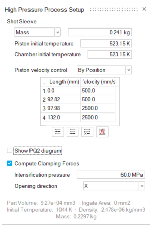

- With Shot Sleeve
- When a shot sleeve is included in the model, the High
- Filled Sleeve
- Select Mass to define the quantity of
metal introduced in the piston shot sleeve in kg or
Sleeve filled % to enter the
percentage that the piston shot is filled after pouring the
liquid in.Note: By default Mass will be automatically computed as the volume of the selected part plus the runner.
- Piston Velocity Control
- Select By position or By
time, and define the piston velocity
profile.
By position allows you to select the first and second velocity when the liquid reaches a selected position on the shot sleeve. The final position will be automatically edited depending on the designed shot sleeve length.
By time allows you to select the first and second piston velocity with respect to the filling time.
You can enter values in the table or edit the points on the graph. Clickto add a new row after a selected data point, add a new row after the last data point, or delete a selected row.
Clickicon to open the velocity plot. You can drag the points on the plot to edit them.

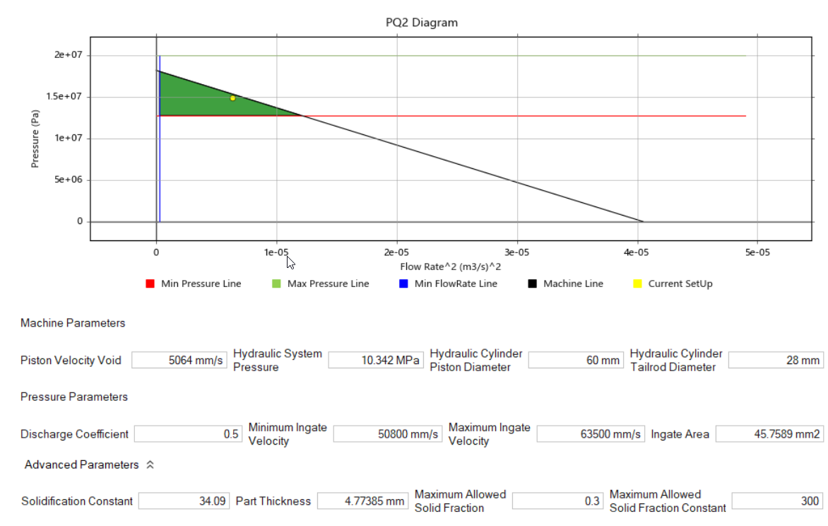

- PQ2 Diagram
- Enable the Show PQ2 diagram option to
reveal this tool. It can help you improve the machine setup
in the high-pressure die casting process. The diagram shows
a green safety region on a pressure vs flow rate graph. The
safety area is defined by the minimum and maximum pressure
and minimum and maximum flow rate during the casting
process. Note: The PQ2 diagram and its parameters are useful only when the model includes a shot sleeve.
The yellow Current Setup point in the diagram shows the current machine setup based on the settings in the Piston Velocity and Ingate Area fields.
