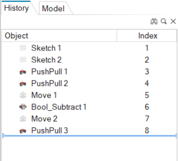

History Browser
Use the History Browser to explore variations on your model’s design without creating additional models.

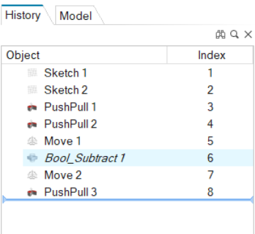

You can edit existing features to change their parameters, or roll your model back to an earlier point in its construction, insert new features, and roll forward to see how the change affects the finished model.
In the History Browser, the editable entities are called construction features (CFs).
The construction features appear in sequential order from top to bottom.

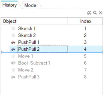

Roll Back and Roll Forward

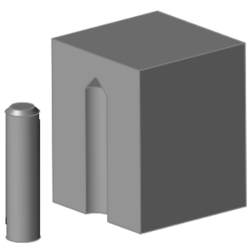

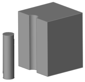

Add a new construction feature at an earlier point in the model’s construction history.

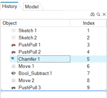

In the History Browser, move the blue end marker to the point where you wish to
add a new construction feature.
- Use one of the tools on the Sketch or Geometry ribbons to add modify your geometry. This will add a new construction feature.
Move the blue end marker to the bottom of the History Browser.

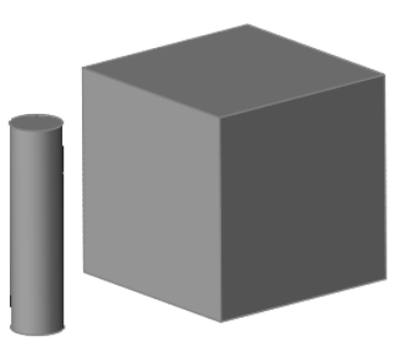

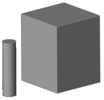

Note: You can also use the end marker to advance through the model’s construction history step by step.In the example above, we added a chamfer to the top of the cylinder prior to the Boolean subtract construction feature.Inspire Cast automatically recomputes the subsequent Push/Pull construction feature, taking the added chamfer into account. Note that the top of the cylindrical cutout is conical in the final model.

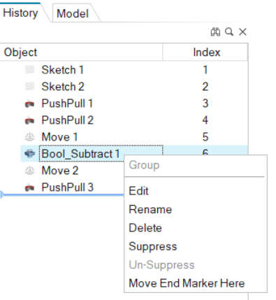

Context Menu Options
The right-click context menu in the History Browser contains the following options for editing the construction history.
