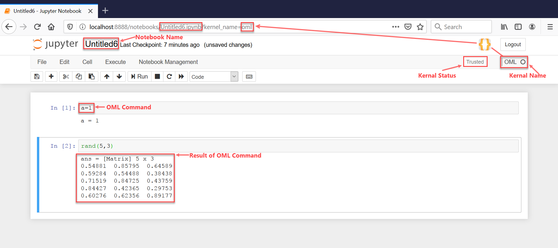

Create and Execute a Compose Notebook
Like other notebooks, a Compose OML Notebook is based on creating and executing cells.
By default, an OML notebook cell is set to receive an OML statement.
- Press Ctrl+Enter to execute the cell.
- If you press Alt+Enter, the cell is not executed and a new cell is created below.
OML Notebook cells can also be used to enter other formatted content using the Markdown format. This allows for entering rich text (such as titles, bold face, and so on) and scientific text (using LateX).
The cell type can be changed from the Cells menu.

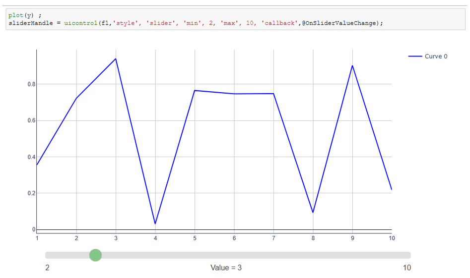

- OML commands related to GUI creation are not supported in
this release. The only exception is the creation of sliders to act on
plots.Example
sliderHandle = uicontrol(f1,'style', 'slider', 'min', 2, 'max', 10, 'callback',@OnSliderValueChange);Figure 2.
