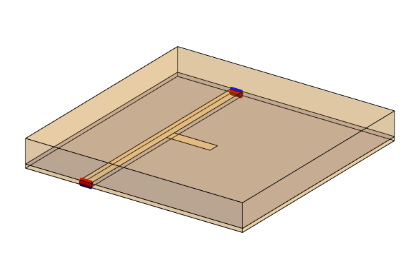

Calculate the S-parameters of a simple microstrip notch filter. Use different solvers and compare the results.
The S-parameter results are compared for the following solvers:
- Finite substrate with FEM method.
- Finite substrate with SEP method.
- Infinite substrate with planar mutilayer substrate (Green's functions).
