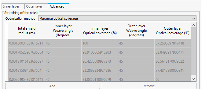

On the Advanced tab, under Stretching of the
shield, for the Optimisation method
drop-down list, select Maximise optical
coverage, to automatically calculate the optimal weave angle and
optical coverage for maximum shielding for the braided inner or braided outer
layer.
The minimum and maximum radius of the double shield is indicated by the top and bottom entry in the Total shield radius column.
Figure 3. The Create Cable Shield dialog, setting the optimisation method for the stretching of a braided shield layer.
Note: For a double braided shield, the stretching of the shield is limited to the stretching capability of both braided layers. The stretching range (Total shield radius range) could be smaller for a double braided shield than for a single braided shield, depending on the braid parameters selected for each shield. -

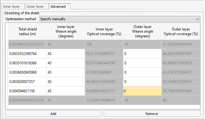

shield, from the Optimisation method
drop-down list, select Specify manually to
manually define values in the stretching table:
- In the Total shield radius field, edit an existing radius.
- In the Inner layer or Outer layer Weave angle column, enter a value for the weave angle in degrees.
Figure 4. The Create Cable Shield dialog, setting the optimisation method for the stretching of a braided shield layer.
Note:- Total shield radius must be between the minimum radius (first row, first cell) and maximum radius (last row, first cell).
- The values in the Inner layer Optical coverage and Outer layer Optical coverage columns, are calculated automatically from the Total shield radius, Inner layer Weave angle and Outer layer Weave angle.
- The Inner layer Weave angle or Outer layer Weave angle values must be between the minimum angle (first row, third cell) and maximum angle (last row, fifth cell).
