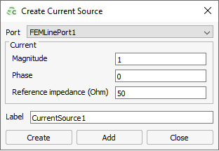

On the Source/Load tab, in the
Sources on Ports group, click the
Current Source icon.
Figure 1. The Create Current Source dialog.
- In the Port field, from the drop-down list, select a port.
- In the Magnitude (A) field, specify the magnitude of the current in Ampere.
- In the Phase (degrees) field, specify the phase of the current source.
In the Reference impedance field, specify the impedance
Note: The reference impedance is used when calculating the input reflection coefficient and realised gain. If this field is empty, default value is taken as 50 Ohm.
- In the Label field, add a unique label for the current source.
- Click the Create button to create the current source and to close the dialog.
