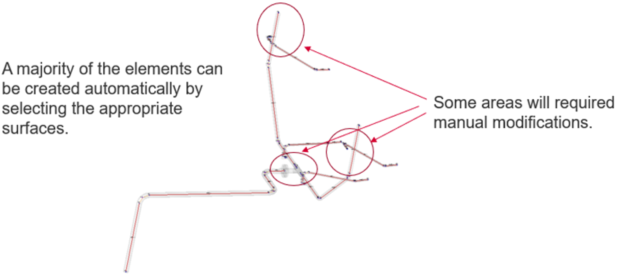

- The model begins with long runs of straight piping connected by 90 degree bends. It then splits in two directions and transitions into smaller diameter pipes, which feed four spray nozzles.
- To model this piping system, use the tube, bend, and junction elements.
- Use CAD to make most of the tubes and bends. The junctions are made manually. The elements around the junctions must be reconnected to the junctions.

Figure 3. Sketch/outline of model - Create tube and bend elements using the CAD geometry. Most of the tubes and bends
can be made quickly using the CAD. This method creates internal momentum chambers
for all elements, which you can change later. The main geometric inputs for the
tubes and bends are calculated by the GUI when using this option.

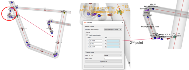

- One of the elbows leading to the nozzle is missing. Use the
Translate option to copy elements from a finished elbow
to this location.
