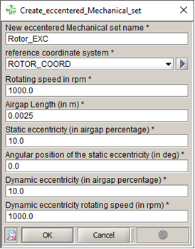

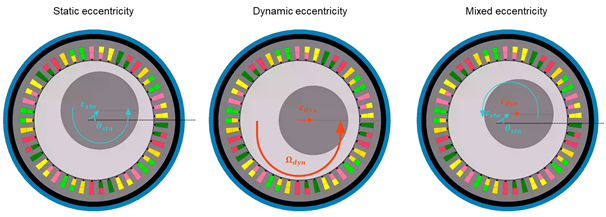

CreateEccenteredMechanicalSet.PFM (New)
Create a mechanical set which defines an eccentered rotor for your electrical motor. You can define any type of eccentricity (static, dynamic or mixed) depending of the inputs of the macro.

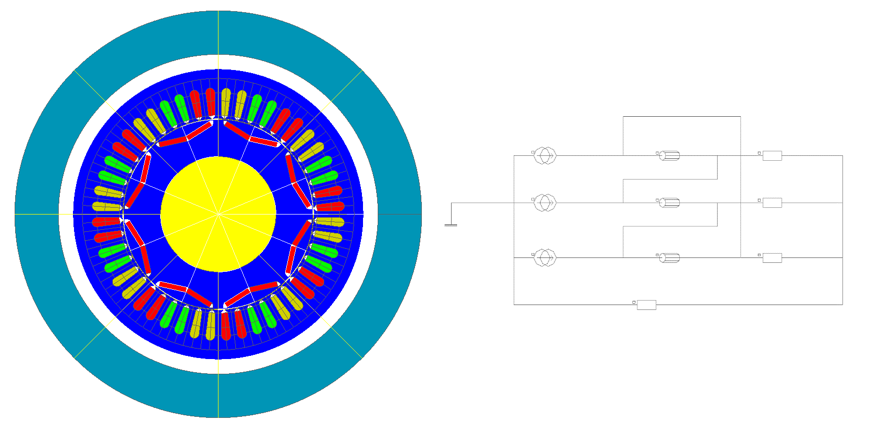

Macro_Flux3D_Postpro /Find_Rotor_Angle_3D.PFM ( Update)
The macro now works for model where a complete geometry is modeled and for a delta coil configuration winding. The coil configuration is detected by using the new function DetectWyeOrDeltaCoilsConnection that has been implemented in this Flux version.

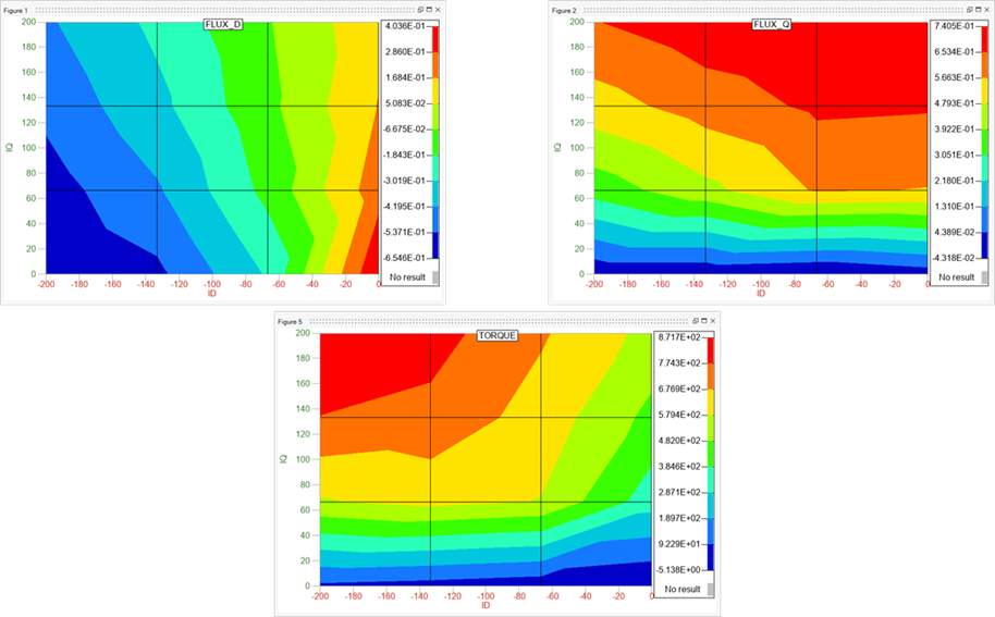

CreateLookUpTableFromTMProjectDQLight.PFM (Update)
Macro now consider any type of formulation (float, mathematic formula, parameter name) of the end winding inductance, especially the one given in a project generated with FluxMotor.
CreateLookUpTableFromTMProjectDQLight3D.PFM & CreateLookUpTableFromTMProjectDQLightSkew.PFM (New)
Adaptation of the CreateLookUpTableFromTMProjectDQLight macro for 3D and Skew projects.

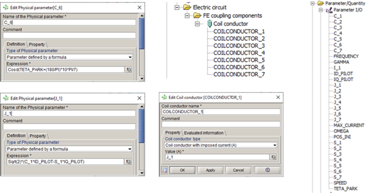

Multi-phase motor analysis macros (New)
All the below macros are adaptation of existing ones for multi-phase motors analysis.
- CreateLookUpTableFromTMProjectDQ_nphases.PFM
Adaptation of the CreateLookUpTableFromTMProjectDQLight macro for supporting any number of phase. CreateLookUpTableFromTMProjectDQ_nphases runs CreatePark_Iabc_Drivenby_Idq_nphases and CreatePark_dq_From_abc_nphases to compute look-up tables of n-phases emotor models.

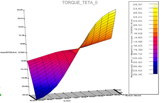

- CreatePark_Iabc_DrivenbyIdq_nphases.PFM
Create IA,B,C,... driven by IDQ and a parametric scenario to compute directly φD, φQ and torque versus ID and IQ.
- CreatePark_dq_From_abc_nphases.PFM
Create DQ parameters from A,B,C, … components using the Park transformation. Here, it computes φD and φQ from φA, φB, φC, ...
