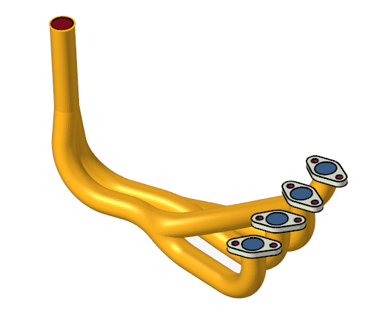

Assign the Flow Boundary Conditions
From the Flow ribbon, click the Constant tool.
Select the manifold inlets highlighted in the figure below.
In the microdialog, set the Inflow velocity type to
Normal, the Normal velocity to
8.0 and the Temperature to
700.

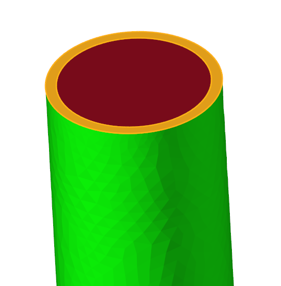

Click the Outlet tool.
Select the face highlighted in the figure below and verify that both the static
pressure and the pressure loss factor are set to 0.

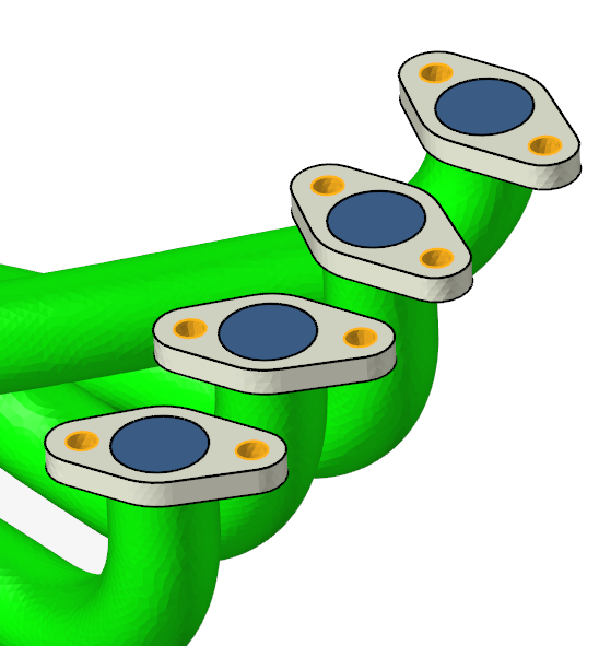

Click the No Slip tool.
Select the wall flanges.
Figure 18.
Note: Make sure you select the bottom and side surfaces of the flanges. In total, 12 surfaces should be selected. -

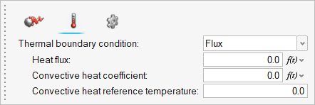

Check that default values are assigned to the thermal boundary
conditions.
