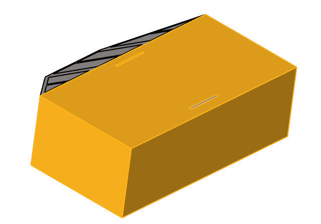

Select all three wall surfaces of the atrium, the roof, and the front glass
walls.
Figure 22. Front-Side of the Model
Figure 23. Back-Side of the Model
In total, 21 surfaces should be selected.
In the microdialog, enter the values shown in the
figure below.

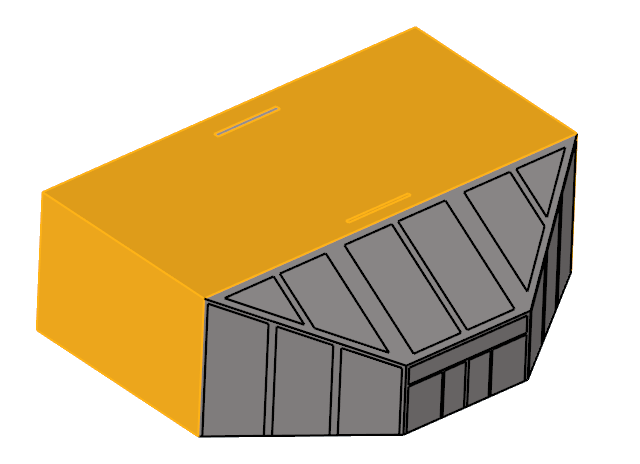

Select all the surfaces except the aluminum frame, as highlighted in the figure
below.
Figure 29.
figure below.
Figure 30.
Click
. In the new microdialog that appears, set the Nodal Output frequency to 1.

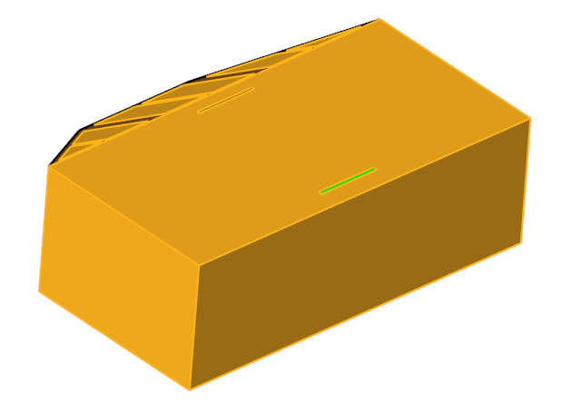

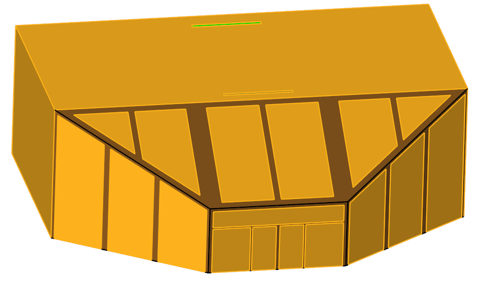

Select the three wall surfaces, the inlet, and the roof surface, as highlighted
in the figures below.
Figure 37. Front-Side of the Model
Figure 38. Back-Side of the Model
In the microdialog, set the Solar radiation model to
BB out then click
on the guide bar.

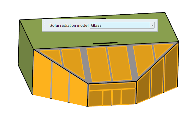

Select all the glass surfaces shown in the figure below, assign the
Glass model to them, then click
on the guide bar.
Figure 39.

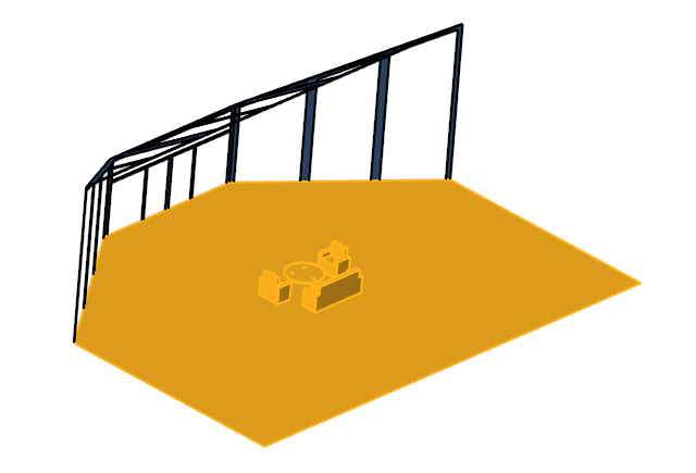

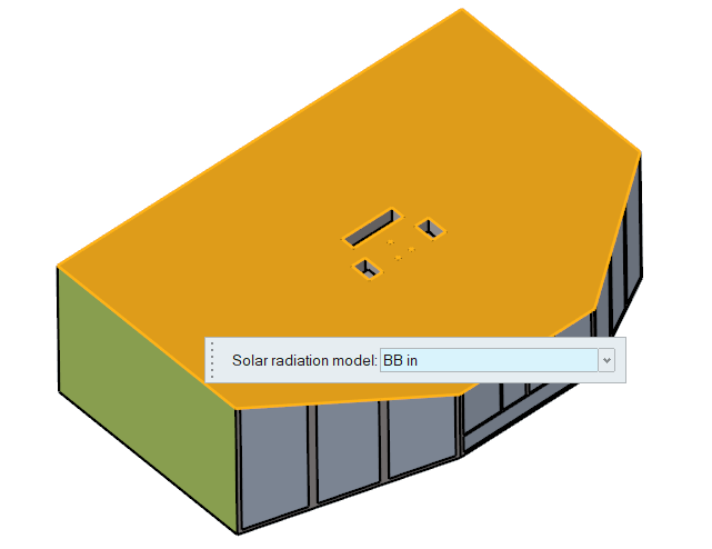

Rotate the model and select the floor surface. In the microdialog, assign the BB in model
then click
on the guide bar.
Figure 40.

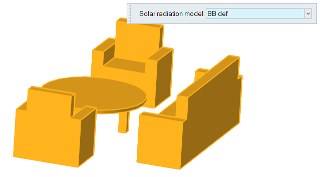

Select the surfaces of the couch, table, and chairs, assign the BB
def model to them, then click
on the guide bar.
Figure 41.

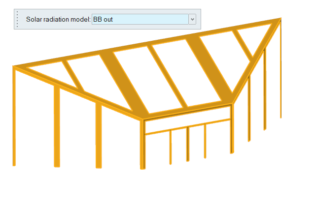

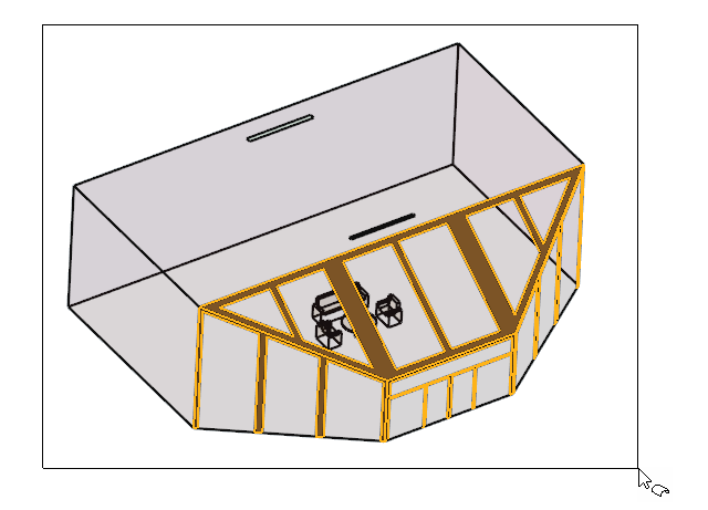

- On the guide bar, change the selection entity to Thin Solids.
Using the window selection method, select the four thin solid surfaces and
assign the BB out model to them.
Figure 42.
On the guide bar, verify that the Direction is set to
Away from Parent Surface then click
to execute the changes.
