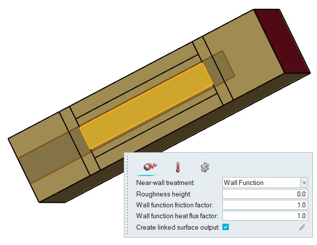

Click the No Slip tool.
Select the face highlighted in the figure below to create the Heated_wall
face.
Click the Temperature tab in the microdialog, set the
Thermal Boundary condition to Temperature, and set the
Temperature value to 403.15.

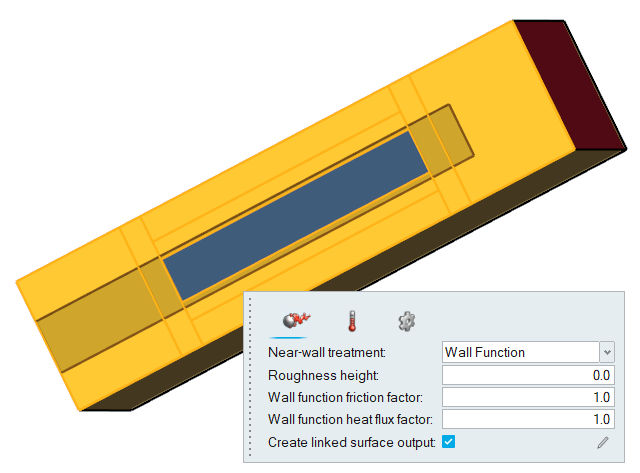

Select the 8 highlighted surfaces shown in the figure below to create the
Bottom_wall faces then click
on the guide bar.
- In the Boundaries legend, rename Wall to Bottom_wall.
