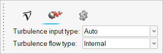

  3. In the microdialog, click the Turbulence tab.
  4. Set the Turbulence input type to Auto.
  5. Set the Turbulence flow type to Internal.
    Figure 9.

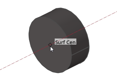

  5. Define the axis of rotation.
    1. Use the Surf Center snap point to place the axis in the middle of the centrifugal blower.
      Figure 16.
