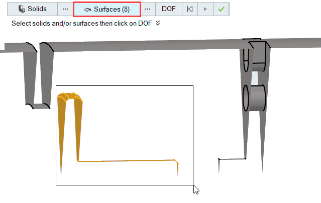

Select the valve wall surfaces, shown in the figure below, by using box
selection (hold and drag the left mouse button).
The number of surfaces selected should be 8, which will show on the guide bar.
Figure 27.

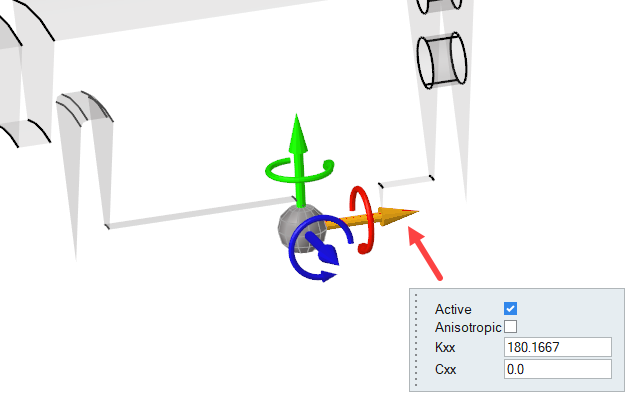

- Click on the X-displacement arrow in the modeling window.
In the microdialog, enter a value of
180.1667 kg/sec2 for Kxx, the stiffness of
the spring.
Figure 29.

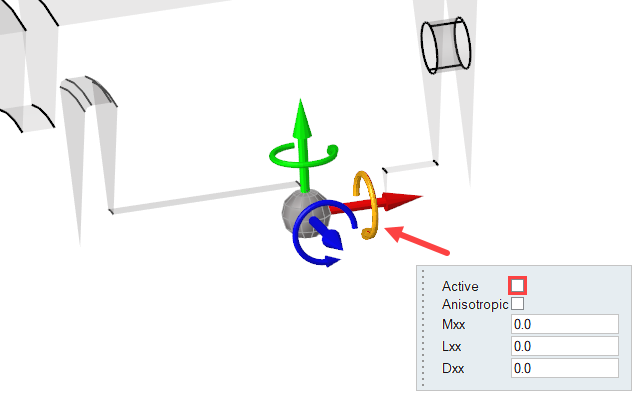

Click on the X-rotation arrow and de-activate it.
Figure 30.
Similarly, click on the remaining four arrows (Y-displacement, Y-rotation,
Z-displacement, and Z-rotation) and de-activate them.
This will ensure that the valve body translates only in the x-direction.

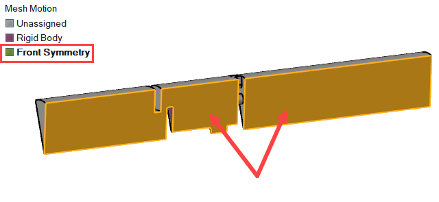

From the Motion ribbon, click the Planar Slip tool.
Figure 31.
- Select the two front symmetry surfaces shown in Figure 32.
In the Mesh Motion legend, rename Planar Slip to
Front_symmetry by double-clicking on the name.
Figure 32.
