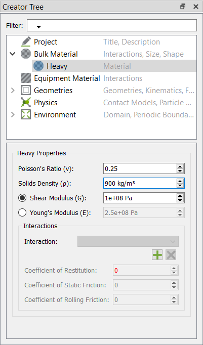

  1. In the Creator Tree, right-click Bulk Material and select Add Bulk Material.
  2. Rename the material to Heavy.
  3. In the Creator Tree, set the Solids Density property to 900 kg/m3.
    You will use the default values for other properties for this tutorial.
    Figure 23.

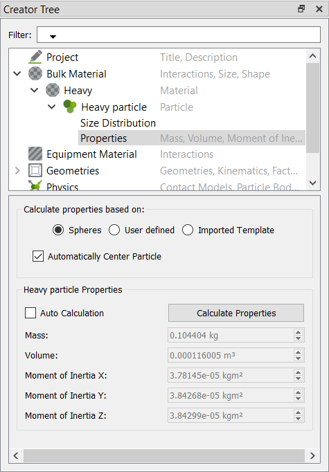

  5. In the Creator Tree, right click Heavy and select Add Shape from Library > Dual Sphere Shape.
  6. Rename the particle to Heavy particle.
  7. Under Heavy particle, click Properties.
  8. In the Heavy particle Spheres panel, set the Physical Radius of both the spheres to 0.03 m and press Enter.
  9. In the Creator Tree, click Calculate Properties.
    Figure 25.

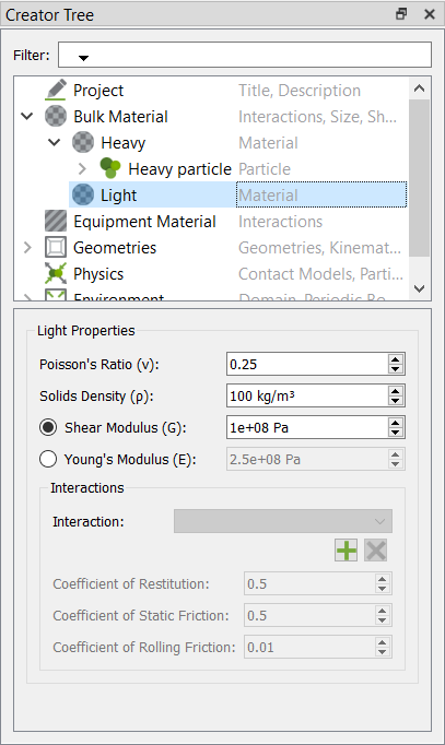

  10. In the Creator Tree, right-click Bulk Material and select Add Bulk Material.
  11. Rename the material to Light.
  12. In the Creator Tree, set the Solids Density property to 100 kg/m3.
    Figure 26.
  13. Click below Interaction to define the interaction properties for collisions among the heavy particles. In the dialog, select Heavy and then click OK.
  14. Click again to define the interaction properties for collisions among the light particles. In the dialog, select Light and then click OK.

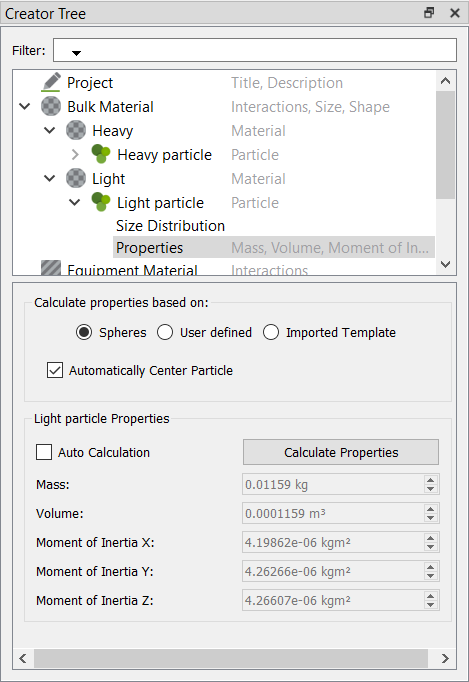

  15. In the Creator Tree, right click on Light and select Add Shape from Library > Dual Sphere Shape.
  16. Rename the particle to Light particle.
  17. Under Light particle, click Properties.
  18. In the Light particle Spheres panel, set the Physical Radius of both the spheres to 0.03 m and press Enter.
    Figure 27.
  19. In the Creator Tree, click Calculate Properties.
    Figure 28.

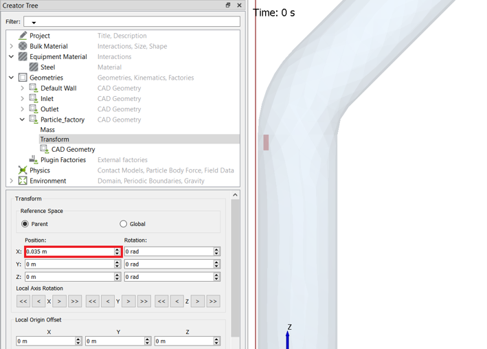

  8. Under Particle_factory, click Transform. Set the X-Position to 0.035 m
    Figure 30.
    Note: Set the Opacity value to 0.2 to see the transformed surface location inside the pipe geometry.
    This is done to make sure that the particles are generated inside the fluid domain.

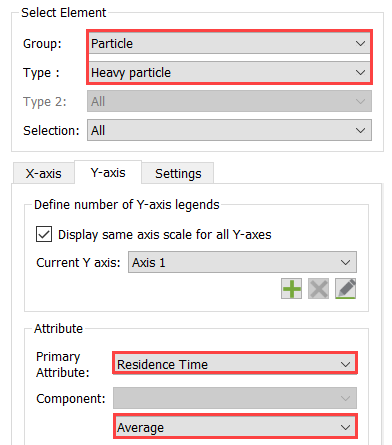

  14. Click the Y-axis tab. Create a plot of average residence time of the heavy particle over the simulation time by setting the values as shown in the figure below.
    Figure 60.

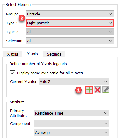

  15. Click to add another Y-axis and set the Type to Light particle.
    Figure 61.
  16. Leave all the other options unchanged and then click Create Graph to create a plot of average residence time of both the particles.
