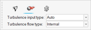

  3. In the microdialog, click the Turbulence tab.
  4. Set the Turbulence input type to Auto.
  5. Set the Turbulence flow type to Internal.
    Figure 9.

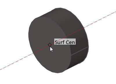

  3. Select the solid in the modeling window.
  4. On the guide bar, click Axis.
  5. Define the axis of rotation.
    1. Use the Surf Center snap point to place the axis in the middle of the centrifugal blower.
      Figure 16.
    2. In the microdialog, click Z to align the axis with the global z axis.
    3. Click to change the rotational direction.
    4. Enter a value of 157.09 in the text field.
    Figure 17.
