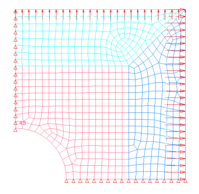

Parametrize Shapes in HyperMorph
If necessary, enable the HyperMorph panel.
Generate the domains and handles that you will use to manipulate the shape of
the mesh and to generate shape perturbations for shape optimization.
