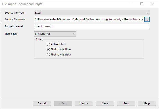

Build Predictive Model in Knowledge Studio
Import doe_1_ooxml.xlsx into Knowledge Studio.

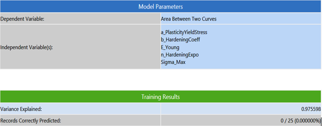

Build a machine learning model of your preference. In this tutorial, Deep
Learning model is selected.
Verify high accuracy is achieved.
If high accuracy cannot be obtained, it may be due to insufficient data. Therefore, another DOE is needed to compensate. Cross-validation, R2, of Deep Learning model is 0.975598.
Figure 3.
