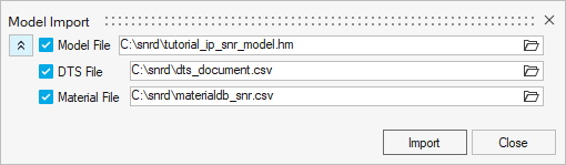

  1. From the HyperMesh NVH menu bar, select Squeak and Rattle.
    The SnRPre and SnRPost ribbons open.
  2. From the SnRPre ribbon, select the Import tool.
  3. Click to open additional options.
  4. Using the file browser option, browse and select files for respective entries.
  5. Click Import.
    The selected model, DTS, and material file are imported to the session.

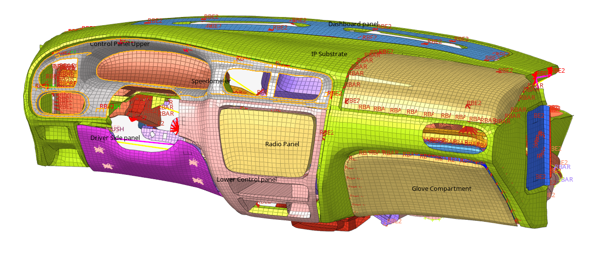

    Figure 3.

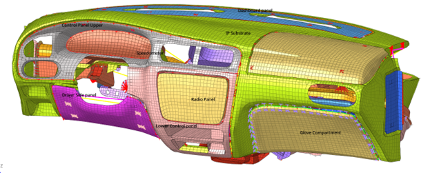

Method Line Type Gap Direction Main Component Secondary Component Interface Name
Manual Rattle Normal to Main IP Substrate Glove Box GloveBox_To_IPsubstrate
Manual Squeak In plane to Main IP Substrate Dashboard Panel Ipsubstrate_To_Dashboardpanel
Manual Rattle In plane to Main Control Panel Upper IP substrate IPsubstrate_To_ControlpanelUpper
Manual Rattle Normal to Main Radio Panel Lower Control Panel Radiopanel_To_ControlPanelLower
Manual Rattle In plane to Main Driver Side Panel Lower Control Panel DriverSidepanel_To_Controlpanellower
Manual Rattle In plane to Main Driver Side Panel IP Substrate DriverSidepanel_To_IPsubstrate
Manual Squeak Normal to Main Speedometer Control Panel Upper Speedometer_To_ControlPanelUpper

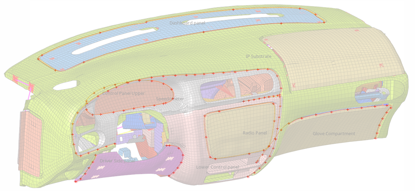

  5. For Line, select the geometric line present at the edge of the Glove Box component.
  6. Click .
    E-Lines are created at the interface and will be highlighted in yellow.
    Figure 8.
  7. Repeat the substeps above to create a squeak line between the IP Substrate and Dashboard Panel.
Once all E-Lines are created, your model should look like Figure 9.

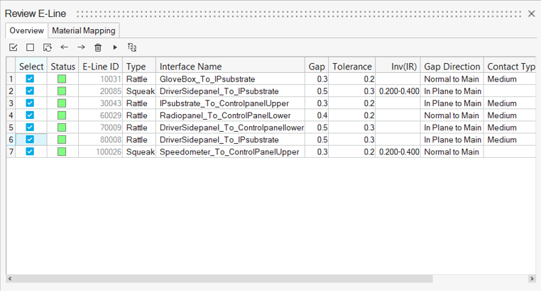

  1. From the SnRPre ribbon, select the Review E-Lines tool from the Manage E-Line tool group.
    Figure 10.
    The Review E-Line dialog opens.
  2. Map the correct interface from the DTS file to the created E-Lines and ensure all other options, like Gap direction, are correct.
    Figure 11.

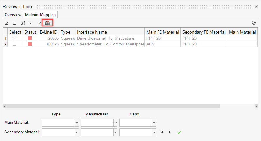

    1. Optional: If an E-Line status is yellow, click to realize and update E-Lines.
  3. From the Material Mapping tab, select the following materials for the two squeak E-Lines.
    1. IPSubstrate_To_Dashboardpanel
      • For Main Material, select PPTD_20.
      • For Secondary Material, select PPTD_20.
    2. Speedometer_To_ControlPanelUpper
      • For Secondary Material, select ABS.
    Tip: In the Review E-Line dialog, click to connect to Ziegler Database and map materials. See Ziegler PEM Material Database for more information.
    Figure 12.

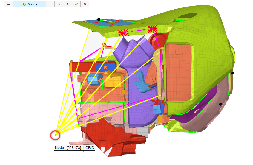

  1. From SnRPre ribbon, select the Dynamic Event tool.
    Figure 13.
  2. In the modeling window, select the node shown in Figure 14.
    Figure 14.
    A microdialog opens.
    Figure 15.
  3. Verify Displacement (D) is selected as load type.
  4. For Load Curve, select From File.
  5. For load directions, select X, Y, and Z.
  6. Select Constrain all Dofs to constrain the excitation nodes in all the other directions.

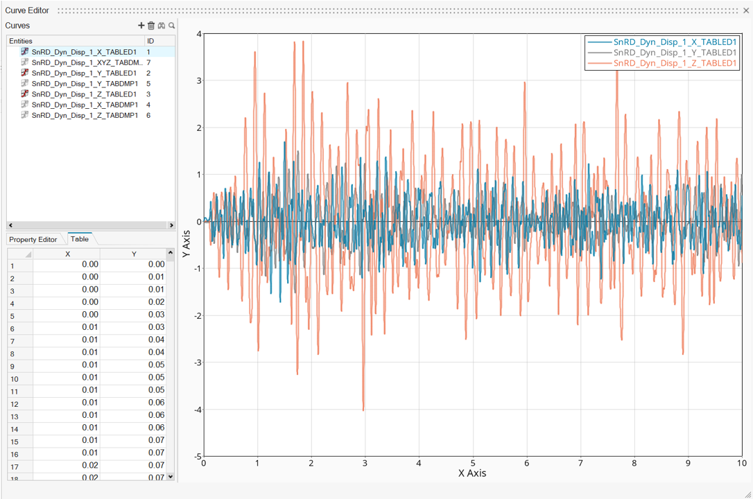

  8. Browse and select the Excitation_XYZ.csv file from the 003_loads folder.

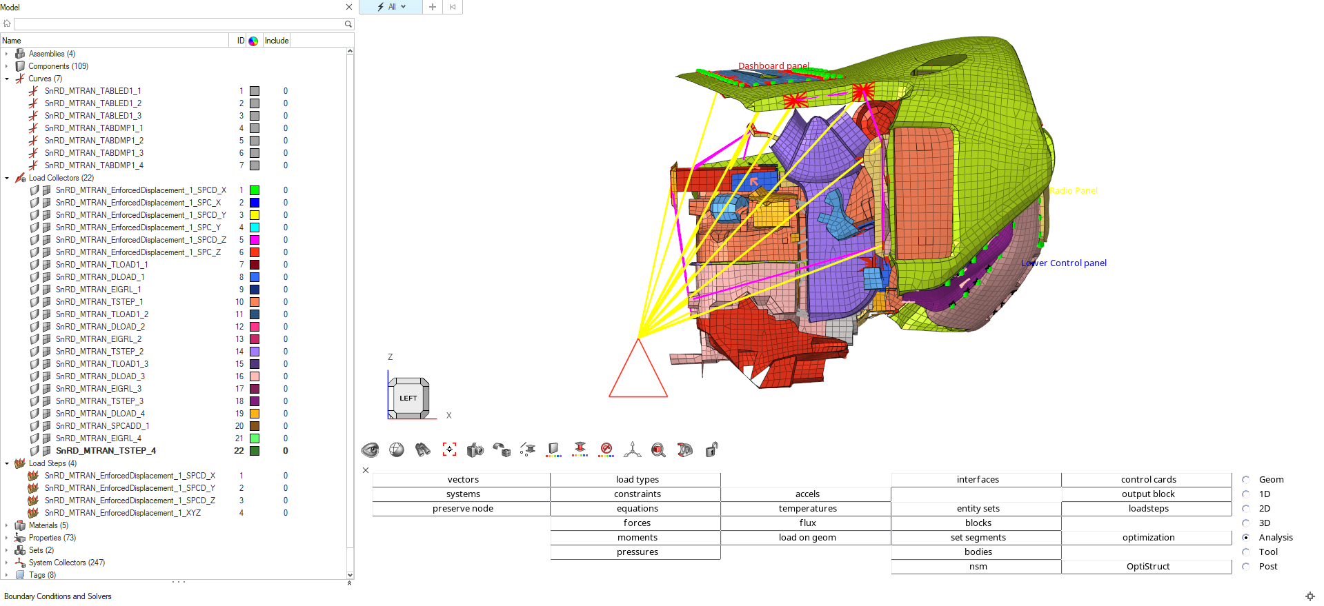

    The required load collectors and other entities required for the simulation are created. The newly created loads are displayed in the Curve Editor dialog.
  9. In the Curve Editor dialog, review the load curves and close the dialog.
    Figure 16.
    Figure 17.
    Tip: You can use the Model Browser to view the new entities.

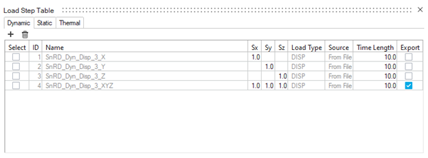

  1. From the SnRPre ribbon, Analyze group, select the Review Loadcases tool.
    Figure 18.
    The Load Step Table dialog opens.
    Figure 19.
  2. Verify the Export checkbox is enabled for the SnRD_Dyn_Disp_#_XYZ entry.
  3. Close the dialog.

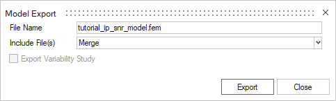

  4. From the SnRPre ribbon, Analyze group, select the Export tool.
    Figure 20.
    The Model Export dialog opens.
    Figure 21.
  5. Click Export.
    A folder selection dialog opens.
  6. Browse and select the required folder.
    The OptiStruct solver deck is exported to the selected folder.
  7. Click Close to close the Model Export dialog.

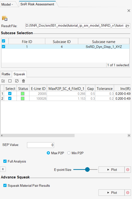

  1. From the SnRPost ribbon, select the Risk Assessment tool.
    Figure 22.
    The SnR Risk Assessment Browser opens.
  2. For Result File, select the .pch file.
    Note: Prior to selecting the .pch file, the .fem and .csv file must already be loaded in the SnRPre ribbon.
  3. Under Subcase Selection, select the subcase.
    The rattle and squeak lines are segregated into separate tabs.
  4. Select the line Ids required to perform post-processing.
  5. For SEP, enter 0.
  6. Verify Full Analysis is selected to see the line-level plots and to continue to next steps of post-processing.
    Important: You must perform full analysis to access Sensitivity Analysis and combined loading capabilities.
    Note: If Full Analysis is not selected, only a summary analysis is generated. Full Analysis is selected by default.
  7. Click Plot.

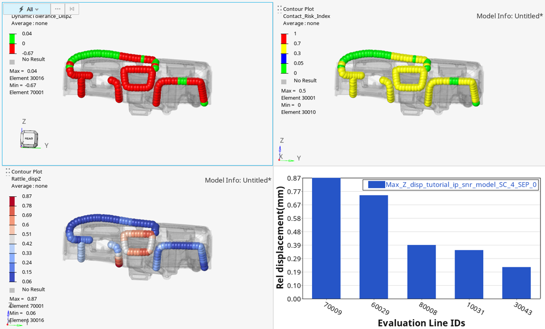

Seven pages are created containing the details and summary for rattle analysis. You must switch to the squeak tab and select the lines for squeak results.
Full analysis creates 11 pages containing all the details. The summary for rattle analysis can be found on page one.
Figure 23. Rattle Summary Dynamic
To access squeak results, you must click on the squeak tab and click Plot. The plots in sequence are as shown below:

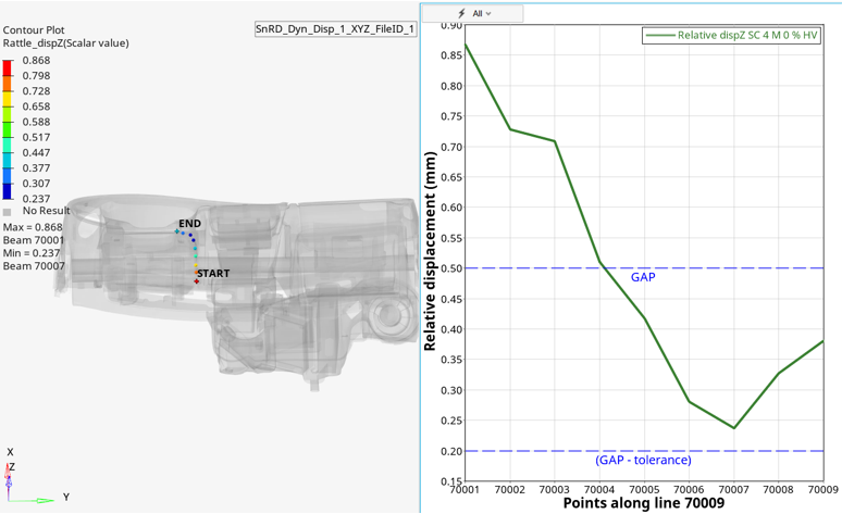

From page one of the Rattle Summary Dynamic, you can see the Rattle line ID 19513009 has the maximum relative displacement. You will perform Sensitivity Analysis to evaluate the effects of modes on the relative displacements.
  1. Navigate to page six to view the Rattle Detailed Dynamic - Line ID 70009 details.
    Figure 26.
    The Relative Displacement of 0.86 mm at the point 70001. This is higher than the Gap and (Gap - Tolerance) values. This indicates a risk of rattle at this particular interface of Driver Side Panel - Lower Control Panel.

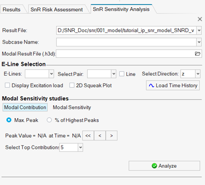

  2. From the SnRPost ribbon, select the Sensitivity Analsysis tool.
    Figure 27.
    The SnR Sensitivity Analysis Browser opens.
    Figure 28.
  3. Define the following parameters.
    1. For Result File, select Tutorial_IP_SNR_Model.pch.
    2. For Subcase Name, select Subcase 4 (SnRD_MTRAN_EnforcedDisplacement_1_XYZ).
    3. For Modal Result File (.H3D), select Tutorial_IP_SNR_Model.h3d.
  4. In the E-Line Selection section, define the following parameters.
    1. For E-Lines, select 70009.
    2. For Select Pair, select Line check box.
    3. For Select Direction, select Z.

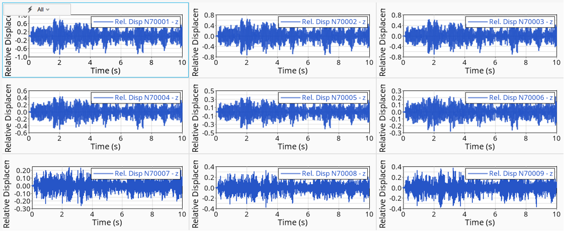

  5. Click Load Time History.
    A working window opens stating the process of plotting relative displacement.
    Figure 29.
    Once complete, the relative displacement plots for all the points in the line are plotted.

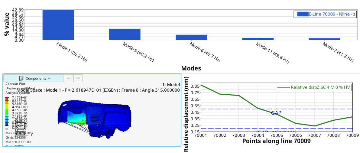

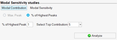

  6. Under the Modal Contribution panel, click Analyze.
    A working dialog opens stating the process of plotting Relative Modal Contribution.
    Figure 31.
    Relative Modal Contribution - Line 70009 - z is created with modes, contour and relative displacement plots for the line.
    Figure 32.
    Figure 33.

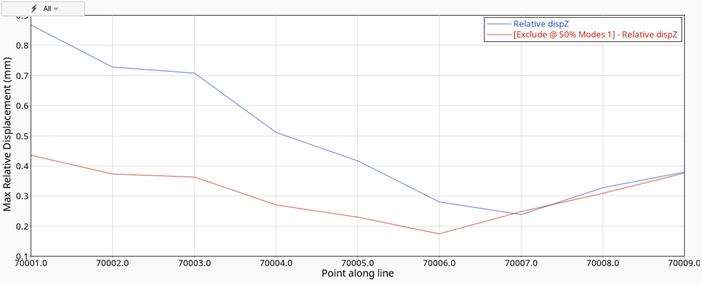

    From the Modes plot, the Mode-4 of value 26.5 Hz is the highest contributing factor for the rattle issue.

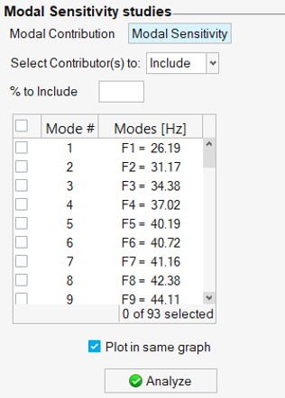

  7. Click Modal Sensitivity under the Modal Sensitivity Studies panel.
    Figure 34.
  8. Select Exclude from the Select Contributor(s) to list.
  9. Enter 50 for % to Exclude value.
  10. Enable the checkbox for mode 4 under the Mode # column.
  11. Click Analyze.
    The Modal Sensitivity for Line (MSL) - Line ID 19513009 -z page is created in the session with the Max Relative Displacement (mm) values plotted against all the interface points.
    Figure 35.
    The relative displacement is reduced when the mode 4 is excluded by 50%.
