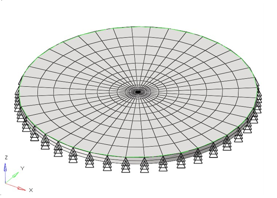

The rubber disk has radius of 7.50 in (190.5 mm) with radially varying element sizes.
Such elements are preferred because the innermost element would be subjected to
maximum extension. Therefore, the innermost elements are shortest in radial length.
Thickness of the disk is 0.5 in (12.7 mm) with 2 elements along the thickness. The
innermost elements are CPENTA and rest of the elements are
CHEXA elements.
The 1, 2, and 3 degrees of freedom of the grids at the circumference are constrained,
and a pressure load of 45 psi is to be applied. The reference results are digitized
from plots in Oden (1972) and Hughes & Carnoy (1981) and used for correlation in
this study. To more accurately correlate the results from the digitized plots, the
total 45 psi pressure load in the OptiStruct run is
divided into multiple continuing nonlinear subcases (using
CNTNLSUB entries to allow subcases to continue solutions from
the end of previous subcases sequentially until the full 45 psi pressure load is
applied).図 1. Model with Boundary Conditions

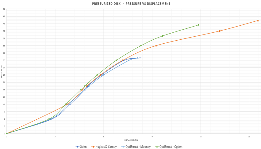

Results
Mooney material model run with OptiStruct correlates well with the results of Oden (1972).
The Mooney and Ogden material model runs correlate very well in the pressure range
of 0 to 12 psi and closely match with Oden (1972). The Hughes & Carnoy (1981)
results are not a close match in this range of pressures.
Within the pressure
range of 12-24 psi there is reasonable correlation among all results and
runs.
From 24 to 31 psi pressures Mooney model is in good agreement with Oden
(1972) and Hughes and Carnoy (1981). The Oden model shows reasonable correlation in

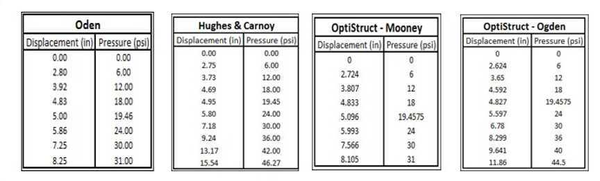

this pressure range.図 2. Displacement at Applied Pressure Values for Oden
Test. Hughes & Carnoy and OptiStruct results
using Mooney and Ogden material models 図 3. Graph of the Oden Test, Hughes and Carnoy Test and
OptiStruct. Mooney and Ogden models
