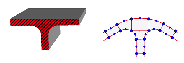

Solid-shell elements form a class of finite element models intermediate between thin shell and conventional solid elements. From geometrical point of view, they are represented by solid meshes with two nodes through the thickness and generally without rotational degree-of-freedom. On the other hand, they account for shell-like behavior in the thickness direction. They are useful for modeling shell-like portions of a 3D structure without the need to connect solid element nodes to shell nodes (図 1).
1. Solid-Shell Elements Application

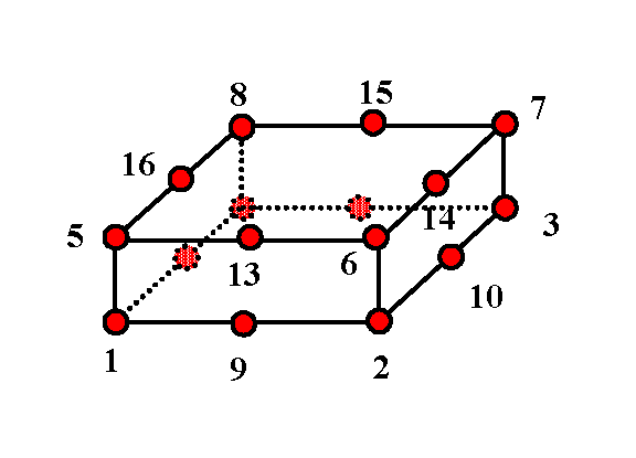

Thick Shell Elements SHELL16

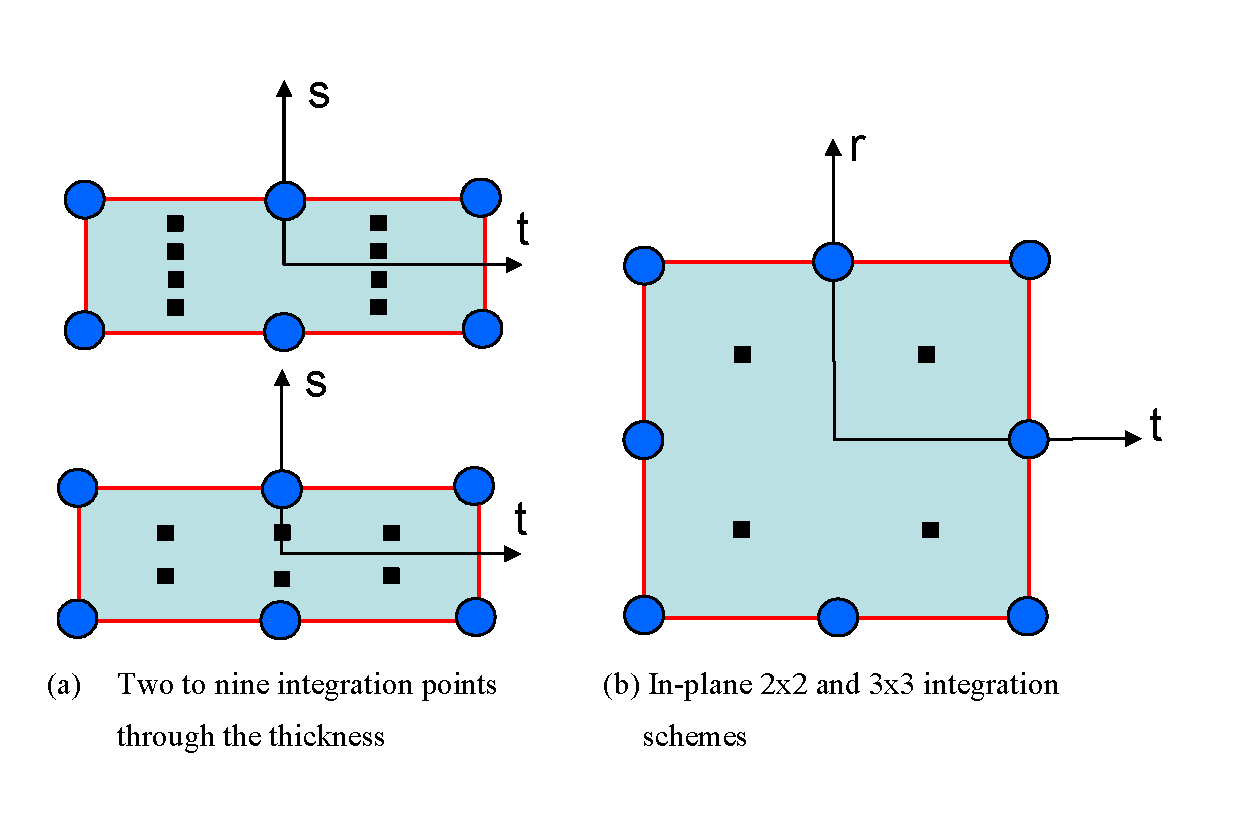

The element can be used to model thick-walled structures situated between 3D solids and thin shells. The element is presented in 図 2. It has 16 nodes with three translational DOFs per each node. The element is quadratic in plane and linear through the thickness. The numerical integration through the thickness is carried out by Gauss-Lobatto schemes rise up to 9 integrations to enhance the quality of elasto-plastic behavior. The in-plane integration may be done by a reduced 2x2 scheme or a fully integrated 3x3 points (図 3). A reduced integration method is applied to the normal stress in order to avoid locking problems.
2. Thick Shell Element SHELL16

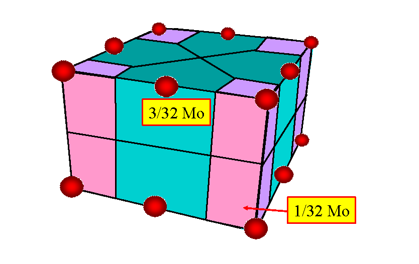

The distribution of mass is not homogenous over the nodes. The internal nodes receive three times more mass than the corner nodes as shown in 図 4.
3. Integration Points for SHELL16
4. Mass Distribution for SHELL16 Element
