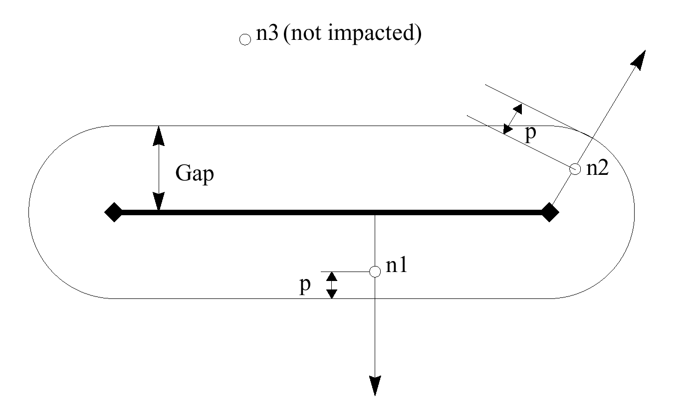

Detection and Gap Size
A secondary node can be detected near a main segment from all directions, as shown in 図 7.
The size of the gap can be user-defined, but Radioss automatically calculates a default gap size, based on the size of the interface elements. For shell elements, the computed gap is the average thickness. For brick elements it is equal to one tenth of the minimum side length.

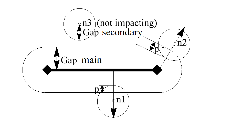

Variable Gap
By default the gap is constant on all main segments.
If the variable gap option is activated, a different gap is used for each contact taking into account the physical thickness on the main and secondary sides.
15. Variable Gap
For shell elements, the main gap is equal to one half of the shell thickness. The secondary gap is equal to one half of the largest thickness of all connected shell elements.
For solid elements, the main gap is zero. If the secondary node is only connected to solid elements, the secondary gap is zero.
For beam or truss elements connected to the secondary node, the secondary gap is one half of the square root of the section area.
If a secondary node is connected to different elements (shell, brick, beam, and truss) the largest gap value is used.
The total gap is the sum of the secondary and main gaps. The total gap cannot be smaller than a minimum gap (user input gap).

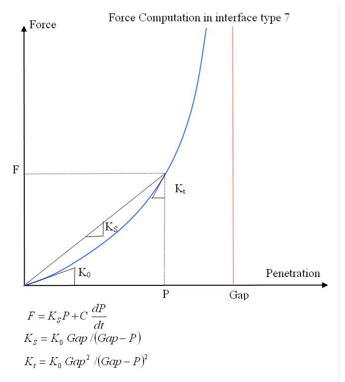

Like the other interface types, TYPE7 has a spring stiffness as a secondary node penetrates the interface gap (previous section). However, there are some fundamental differences in the determination of the reaction force. 図 9 shows a graph of force versus penetration of a node on a main segment. This figure also shows a pictorial diagram of node penetration and the associated forces.
17. Penetration Reaction Force
The reaction force is not a linear relation like the previous interfaces. There is a viscous damping which acts on the rate of penetration.
The force computation is given by:
18.
F = K s P + C d P d t
Where,
K s = K 0 ( G a p G a p P )
C = V I S s 2 K s M
K 0 MathType@MTEF@5@5@+= feaagKart1ev2aaatCvAUfeBSjuyZL2yd9gzLbvyNv2CaerbuLwBLn hiov2DGi1BTfMBaeXatLxBI9gBaerbd9wDYLwzYbItLDharqqtubsr 4rNCHbGeaGqiVu0Je9sqqrpepC0xbbL8F4rqqrFfpeea0xe9Lq=Jc9 vqaqpepm0xbba9pwe9Q8fs0=yqaqpepae9pg0FirpepeKkFr0xfr=x fr=xb9adbaqaaeGaciGaaiaabeqaamaabaabaaGcbaGaam4samaaBa aaleaacaaIWaaabeaaaaa@37AC@
Initial interface spring stiffness (as in TYPE5)
VI S s MathType@MTEF@5@5@+= feaagKart1ev2aaatCvAUfeBSjuyZL2yd9gzLbvyNv2CaerbuLwBLn hiov2DGi1BTfMBaeXatLxBI9gBaerbd9wDYLwzYbItLDharqqtubsr 4rNCHbGeaGqiVu0Je9sqqrpepC0xbbL8F4rqqrFfpeea0xe9Lq=Jc9 vqaqpepm0xbba9pwe9Q8fs0=yqaqpepae9pg0FirpepeKkFr0xfr=x fr=xb9adbaqaaeGaciGaaiaabeqaamaabaabaaGcbaGaamOvaiaadM eacaWGtbWaaSbaaSqaaiaadohaaeqaaaaa@399B@
Critical damping coefficient on interface stiffness (input)
The instantaneous stiffness is given by:
19.
K t = K 0 ( G a p 2 ( G a p P ) 2 )
20. Force - Penetration Graph
A critical viscous damping is required to be defined on the TYPE7 input card for both damping on the spring stiffness and for interface friction damping.

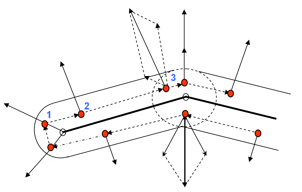

Force Orientation
Due to the gap on a TYPE7 interface extending around the edges of a segment, the reaction forces over a surface will be smooth.
Penetration Reaction, 図 10 shows the reaction forces on a node at various positions around two adjoining segments.
21. Force Orientation
Position 1 in 図 11 shows the force acting radially from the edge of the segment. The size of the force depends on the amount of penetration. At position 2 the force is normal to the segment surface. In position 3 two segments intersect and their gaps overlap. The result is that each segment applies a force to the node, normal to the respective segment, this may double the force for the distance of gap overlap.
