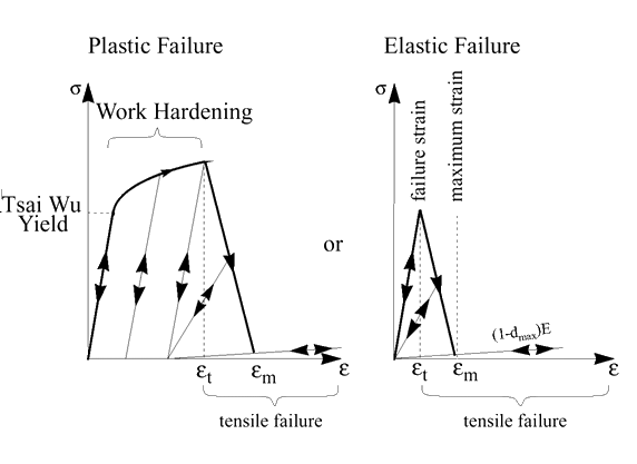

Tensile Behavior
The tensile behavior is shown in 図 2. The behavior starts with an elastic phase. Then, reached to the yield state, the material may undergo an elastic-plastic work hardening with anisotropic Tsai-Wu yield criteria. It is possible to take into account the material damage. The failure can occur in the elastic stage or after plastification. It is started by a damage phase then conducted by the formation of a crack. The maximum damage factor will allow these two phases to separate. The unloading can happen during the elastic, elastic-plastic or damage phase. The damage factor d MathType@MTEF@5@5@+= feaagKart1ev2aaatCvAUfeBSjuyZL2yd9gzLbvyNv2CaerbwvMCKf MBHbqefqvATv2CG4uz3bIuV1wyUbqedmvETj2BSbqefm0B1jxALjhi ov2DaebbnrfifHhDYfgasaacH8srps0lbbf9q8WrFfeuY=Hhbbf9v8 qqaqFr0xc9pk0xbba9q8WqFfea0=yr0RYxir=Jbba9q8aq0=yq=He9 q8qqQ8frFve9Fve9Ff0dmeaacaGacmGadaWaaiqacaabaiaafaaake aacaWGKbaaaa@39C0@ varies during deformation as in the case of isotropic material laws (LAW27). However, three damage factors are computed; two damage factors d 1 MathType@MTEF@5@5@+= feaagKart1ev2aaatCvAUfeBSjuyZL2yd9gzLbvyNv2CaerbuLwBLn hiov2DGi1BTfMBaeXatLxBI9gBaerbd9wDYLwzYbItLDharqqtubsr 4rNCHbGeaGqiVu0Je9sqqrpepC0xbbL8F4rqqrFfpeea0xe9Lq=Jc9 vqaqpepm0xbba9pwe9Q8fs0=yqaqpepae9pg0FirpepeKkFr0xfr=x fr=xb9adbaqaaeGaciGaaiaabeqaamaabaabaaGcbaGaamizamaaBa aaleaacaaIXaaabeaaaaa@37C6@ and d 2 MathType@MTEF@5@5@+= feaagKart1ev2aaatCvAUfeBSjuyZL2yd9gzLbvyNv2CaerbuLwBLn hiov2DGi1BTfMBaeXatLxBI9gBaerbd9wDYLwzYbItLDharqqtubsr 4rNCHbGeaGqiVu0Je9sqqrpepC0xbbL8F4rqqrFfpeea0xe9Lq=Jc9 vqaqpepm0xbba9pwe9Q8fs0=yqaqpepae9pg0FirpepeKkFr0xfr=x fr=xb9adbaqaaeGaciGaaiaabeqaamaabaabaaGcbaGaamizamaaBa aaleaacaaIXaaabeaaaaa@37C6@ for orthotropy directions and the other d 3 MathType@MTEF@5@5@+= feaagKart1ev2aaatCvAUfeBSjuyZL2yd9gzLbvyNv2CaerbuLwBLn hiov2DGi1BTfMBaeXatLxBI9gBaerbd9wDYLwzYbItLDharqqtubsr 4rNCHbGeaGqiVu0Je9sqqrpepC0xbbL8F4rqqrFfpeea0xe9Lq=Jc9 vqaqpepm0xbba9pwe9Q8fs0=yqaqpepae9pg0FirpepeKkFr0xfr=x fr=xb9adbaqaaeGaciGaaiaabeqaamaabaabaaGcbaGaamizamaaBa aaleaacaaIXaaabeaaaaa@37C6@ for delamination:
1.
σ 11 = E 11 ( 1 d 1 ) ε 11 σ 22 = E 22 ( 1 d 2 ) ε 22 σ 12 = G 12 ( 1 d 1 ) ( 1 d 2 ) γ 12

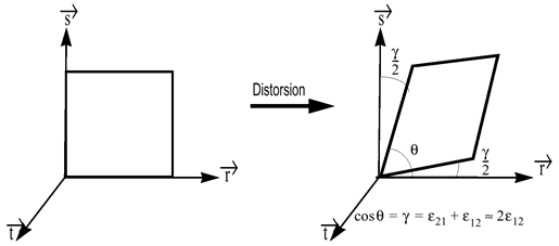

2. Shear Strain
Where, d 1 MathType@MTEF@5@5@+= feaagKart1ev2aaatCvAUfeBSjuyZL2yd9gzLbvyNv2CaerbuLwBLn hiov2DGi1BTfMBaeXatLxBI9gBaerbd9wDYLwzYbItLDharqqtubsr 4rNCHbGeaGqiVu0Je9sqqrpepC0xbbL8F4rqqrFfpeea0xe9Lq=Jc9 vqaqpepm0xbba9pwe9Q8fs0=yqaqpepae9pg0FirpepeKkFr0xfr=x fr=xb9adbaqaaeGaciGaaiaabeqaamaabaabaaGcbaGaamizamaaBa aaleaacaaIXaaabeaaaaa@37C6@ and d 2 MathType@MTEF@5@5@+= feaagKart1ev2aaatCvAUfeBSjuyZL2yd9gzLbvyNv2CaerbuLwBLn hiov2DGi1BTfMBaeXatLxBI9gBaerbd9wDYLwzYbItLDharqqtubsr 4rNCHbGeaGqiVu0Je9sqqrpepC0xbbL8F4rqqrFfpeea0xe9Lq=Jc9 vqaqpepm0xbba9pwe9Q8fs0=yqaqpepae9pg0FirpepeKkFr0xfr=x fr=xb9adbaqaaeGaciGaaiaabeqaamaabaabaaGcbaGaamizamaaBa aaleaacaaIXaaabeaaaaa@37C6@ are the tensile damages factors. The damage and failure behavior is defined by introduction of the following input parameters:
ε t 1
Tensile failure strain in direction 1
ε m 1
Maximum strain in direction 1
ε t 2
Tensile failure strain in direction 2
ε m 2
Maximum strain in direction 2
dmax
Maximum damage (residual stiffness after failure)

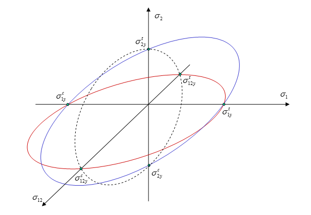

The Tsai-Wu criteria are used to determine the material behavior:
14.
  • F ( σ ) < 1 : elastic state
  • F ( σ ) = 1 : plastic admissible state
  • F ( σ ) > 1 : plastically inadmissible stresses
For F ( σ ) = 1 the cross-sections of Tsai-Wu function with the planes of stresses in orthotropic directions is shown in 図 3.
15. Cross-sections of Tsai-Wu Yield Surface For F ( σ ) = 1

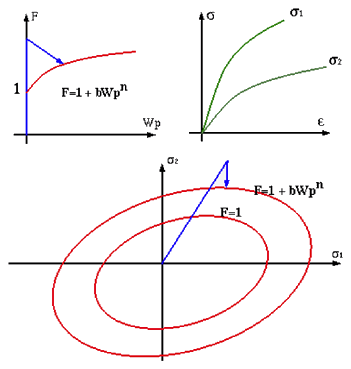

If F ( σ ) > 1 , the stresses must be projected on the yield surface to satisfy the flow rule. F ( σ ) is compared to a maximum value F ( W p ) MathType@MTEF@5@5@+= feaagKart1ev2aaatCvAUfeBSjuyZL2yd9gzLbvyNv2CaerbuLwBLn hiov2DGi1BTfMBaeXatLxBI9gBaerbd9wDYLwzYbItLDharqqtubsr 4rNCHbGeaGqiVu0Je9sqqrpepC0xbbL8F4rqqrFfpeea0xe9Lq=Jc9 vqaqpepm0xbba9pwe9Q8fs0=yqaqpepae9pg0FirpepeKkFr0xfr=x fr=xb9adbaqaaeGaciGaaiaabeqaamaabaabaaGcbaGaamOramaabm aabaGaam4vamaaBaaaleaacaWGWbaabeaaaOGaayjkaiaawMcaaaaa @3A51@ varying in function of the plastic work W p MathType@MTEF@5@5@+= feaagKart1ev2aaatCvAUfeBSjuyZL2yd9gzLbvyNv2CaerbuLwBLn hiov2DGi1BTfMBaeXatLxBI9gBaerbd9wDYLwzYbItLDharqqtubsr 4rNCHbGeaGqiVu0Je9sqqrpepC0xbbL8F4rqqrFfpeea0xe9Lq=Jc9 vqaqpepm0xbba9pwe9Q8fs0=yqaqpepae9pg0FirpepeKkFr0xfr=x fr=xb9adbaqaaeGaciGaaiaabeqaamaabaabaaGcbaGaam4vamaaBa aaleaacaWGWbaabeaaaaa@37F3@ during work hardening phase:
16.
F ( σ ) = F ( W p ) = 1 + b W p n
Where,
b MathType@MTEF@5@5@+= feaagKart1ev2aaatCvAUfeBSjuyZL2yd9gzLbvyNv2CaerbuLwBLn hiov2DGi1BTfMBaeXatLxBI9gBaerbd9wDYLwzYbItLDharqqtubsr 4rNCHbGeaGqiVu0Je9sqqrpepC0xbbL8F4rqqrFfpeea0xe9Lq=Jc9 vqaqpepm0xbba9pwe9Q8fs0=yqaqpepae9pg0FirpepeKkFr0xfr=x fr=xb9adbaqaaeGaciGaaiaabeqaamaabaabaaGcbaGaamOyaaaa@36DD@
Hardening parameter
n MathType@MTEF@5@5@+= feaagKart1ev2aaatCvAUfeBSjuyZL2yd9gzLbvyNv2CaerbuLwBLn hiov2DGi1BTfMBaeXatLxBI9gBaerbd9wDYLwzYbItLDharqqtubsr 4rNCHbGeaGqiVu0Je9sqqrpepC0xbbL8F4rqqrFfpeea0xe9Lq=Jc9 vqaqpepm0xbba9pwe9Q8fs0=yqaqpepae9pg0FirpepeKkFr0xfr=x fr=xb9adbaqaaeGaciGaaiaabeqaamaabaabaaGcbaGaamOyaaaa@36DD@
Hardening exponent

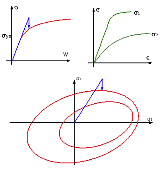

Therefore, the plasticity hardening is isotropic as illustrated in 図 4.
17. Isotropic Plasticity Hardening

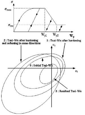

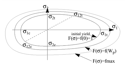

Failure Behavior
The Tsai-Wu flow surface is also used to estimate the material rupture by means of two variables:
  • plastic work limit W p max ,
  • maximum value of yield function F max MathType@MTEF@5@5@+= feaagKart1ev2aaatCvAUfeBSjuyZL2yd9gzLbvyNv2CaerbwvMCKf MBHbqefqvATv2CG4uz3bIuV1wyUbqedmvETj2BSbqefm0B1jxALjhi ov2DaebbnrfifHhDYfgasaacH8srps0lbbf9q8WrFfeuY=Hhbbf9v8 qqaqFr0xc9pk0xbba9q8WqFfea0=yr0RYxir=Jbba9q8aq0=yq=He9 q8qqQ8frFve9Fve9Ff0dmeaacaGacmGadaWaaiqacaabaiaafaaake GabaaVqiaadAeadaWgaaWcbaGaciyBaiaacggacaGG4baabeaaaaa@3D71@
If one of the two conditions is satisfied, the material is ruptured. The evolution of yield surface during work hardening of the material is shown in 図 5.
18. Evolution of Tsai-Wu Yield Surface

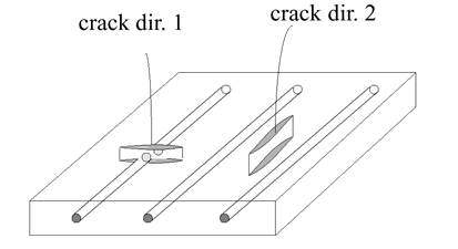

The model will allow the simulation of the brittle failure by formation of cracks. The cracks can either be oriented parallel or perpendicular to the orthotropic reference frame (or fiber direction), as shown in 図 6. For plastic failure, if the plastic work W p MathType@MTEF@5@5@+= feaagKart1ev2aaatCvAUfeBSjuyZL2yd9gzLbvyNv2CaerbwvMCKf MBHbqefqvATv2CG4uz3bIuV1wyUbqedmvETj2BSbqefm0B1jxALjhi ov2DaebbnrfifHhDYfgasaacH8srps0lbbf9q8WrFfeuY=Hhbbf9v8 qqaqFr0xc9pk0xbba9q8WqFfea0=yr0RYxir=Jbba9q8aq0=yq=He9 q8qqQ8frFve9Fve9Ff0dmeaacaGacmGadaWaaiqacaabaiaafaaake aacaWGxbWaaSbaaSqaaiaadchaaeqaaaaa@3AD4@ is larger than the maximum value W p max for a given element, then the element is considered to be ruptured. However, for a multi-layer shell, several criteria may be considered to model a total failure. The failure may happen:
  • If W p > W p max for one layer,
  • If W p > W p max for all layers,
  • If W p > W p max or tensile failure in direction 1 for each layer,
  • If W p > W p max or tensile failure in direction 2 for each layer,
  • If W p > W p max or tensile failure in directions 1 and 2 for each layer,
  • If W p > W p max or tensile failure in direction 1 for all layers,
  • If W p > W p max or tensile failure in direction 2 for all layers,
  • If W p > W p max or tensile failure in directions 1 and 2 for each layer.
The last two cases are the most physical behaviors; but the use of failure criteria depends, at first, to the analyst’s choice. In Radioss the flag Ioff defines the used failure criteria in the computation.
19. Crack Orientation

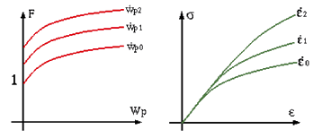

Strain Rate Effect
The strain rate is taken into account within the modification of Plastic Behavior, 式 13 which acts through a scale factor:
20.
F ( W p , ε ˙ ) = ( 1 + b ( W p W p r e f ) n ) ( 1 + c ln ( ε ˙ ε ˙ 0 ) )
Where,
Plastic work
W p r e f
Reference plastic work
Plastic hardening parameter
Plastic hardening exponent
c MathType@MTEF@5@5@+= feaagKart1ev2aaatCvAUfeBSjuyZL2yd9gzLbvyNv2CaerbuLwBLn hiov2DGi1BTfMBaeXatLxBI9gBaerbd9wDYLwzYbItLDharqqtubsr 4rNCHbGeaGqiVu0Je9sqqrpepC0xbbL8F4rqqrFfpeea0xe9Lq=Jc9 vqaqpepm0xbba9pwe9Q8fs0=yqaqpepae9pg0FirpepeKkFr0xfr=x fr=xb9adbaqaaeGaciGaaiaabeqaamaabaabaaGcbaGaamOyaaaa@36DD@
Strain rate coefficient (equal to zero for static loading)
The last equation implies the growing of the Tsai-Wu yield surface when the dynamic effects are increasing. The effects of strain rate are illustrated in 図 7.
21. Strain Rate Effect in Work Hardening

The CRASURV model will allow the simulation of the ductile failure of orthotropic shells. The plastic and failure behaviors are different in tension and in compression. The stress softening may also be introduced in the model to take into account the residual Tsai-Wu stresses. The evolution of CRASURV criteria with hardening and softening works is illustrated in 図 9.
28. Flow Surface in CRASURV Model
