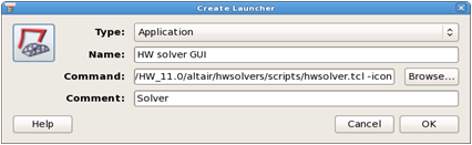

- Right-click on the desktop, and select Create Launcher.The following form will appear.
- Fill in the Command field with the following
text:
<install_dir>/scripts/hw_wish <install_dir>hwsolvers/scripts/hwsolver.tcl -icon
Where, <install_dir> is the top directory path to the Altair HyperWorks installation.
- Choose the content for the Name and Comment fields and click on the image in the
left-top corner to browse for the icon image.
In the example above, the icon was selected from <install_dir>/hw/images/productOptiStruct-32.png, but the actual choice is not important.
Higher resolution images are also available from <install_dir>/hwsolvers/scripts/.
- Click OK.
