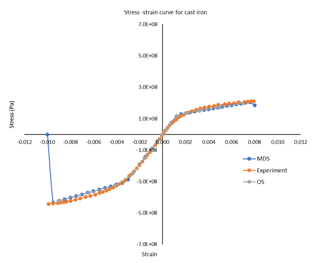

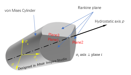

Cast Iron Plasticity material can be defined using MCIRON Bulk Data Entry.

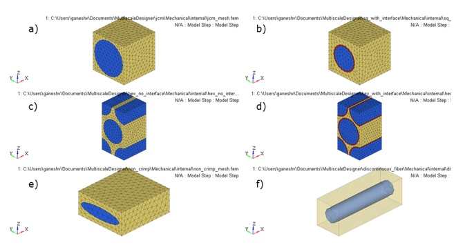

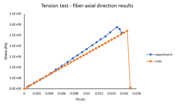

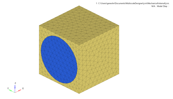

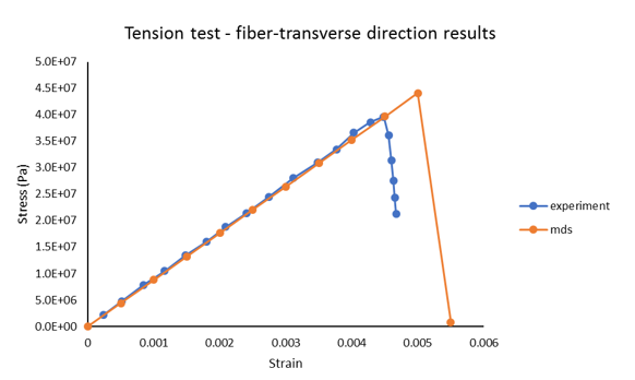

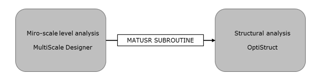

Material models can also be defined using Multiscale Designer and used via the MATMDS entry.

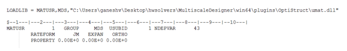

User-Defined Structural Material
The MATUSR Bulk Data Entry, in combination with the LOADLIB I/O Option Entry, allows for the definition of structural material through user-defined external functions.
The external functions may be written in Fortran, C or C++. The resulting libraries and files should be accessible by OptiStruct regardless of the coding language, provided that consistent function prototyping is respected, and adequate compiling and linking options are used.

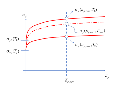

Temperature-dependent combined hardening
If temperature-dependent combined hardening is active, then all the parameters are temperature dependent, for example,
From experiment is only possible to test a limited number of temperatures. Interpolation is used to solving for plasticity at a temperature in between the test temperatures.
Using isotropic hardening NLISO as an example, if the parameters are provided at two temperatures and , then there are two yield stress functions for interpolation:
The interpolated yield stress at the current temperature in [ , ] is then,
with two factors for different temperatures , .
As an example, Figure 2 illustrates the principle of interpolation.
If the temperature, is beyond the available temperature range [ , ], then closest temperature will be selected. In other words, no extrapolation of temperature is performed. Furthermore, it is suggested to provide the material parameter of NLKIN and NLISO at the same temperature.

Yield Function
The yielding criteria is defined as:
Where,
The first criterion is Rankine criterion (max. Principal stress criterion) for tensile yielding, and the second criterion is von Mises criterion for compressive yielding. Together they form a composite yield surface.
- Yield stress in uniaxial tension.
- Yield stress in uniaxial compression.
Since the material is assumed to be isotropic, the yield surface can be expressed with a function of three invariant measure of the stress tensor, , , and .
Where, is von Mises stress of a given stress state.
Where, is mean stress given by:
The invariant can be expressed as:
Where, is the tensor form of deviatoric stress.

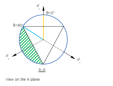

The quantity is Lode’s Angle that is defined by and as shown below, which identifies the meridional plane for a given stress state.

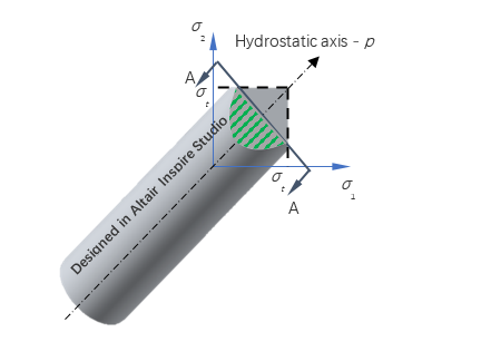

In the principal stress space, the yield function is a von Mises cylinder intersected with Rankine planes (Figure 3). The yield surface is illustrated in plane in Figure 4 and Figure 5, and in meridional plane in Figure 6.

Multiscale Modeling
OptiStruct (OS) and Multiscale Designer (MDS) can be combined to perform multiscaling analysis on structural components utilizing both linear and nonlinear materials.
Heterogeneous materials such as composites, soil, solid foams, and polycrystals consist of one or more distinguishable constituents that have different mechanical properties. 12 For example, it is known that fiber-reinforced composite materials have a stiffer and stronger phase known as the reinforcement and, a less stiff and weaker phase known as the matrix. The governing equations are well understood in one of the scales, either the micro-scale or the macro-scale. While general constitutive equations are applicable to solids under deformation in the macro-scale, continuum models are required in the micro-scale. In order to bridge the gap between the two scales, you need to consider models at different scales simultaneously. This can be achieved by multiscaling techniques.
Classical laminate theory can predict the overall properties of heterogeneous laminates; whereas, homogenization theory provides information on the individual phase properties and phase geometries. Knowledge of individual phases is important to characterize material damage and failure. Hence, multiscaling techniques open unique opportunities for modeling by focusing the material behavior on different levels of physical laws.
- Unit cell geometry and mesh definition
- Linear material characterization
- Reduced-order homogenization
- Nonlinear material characterization
Single-scale Model
The basic steps required to construct a single-scale material model.
Cast iron plasticity is interesting to study because it has different yielding and hardening behavior when subjected to tensile and compressive loads. The first two sections explain the input data required from the Multiscale Designer (MDS). The next two sections explain the procedure to integrate the material in OptiStruct (OS) and perform structural analysis.
Linear Material Characterization
- isotropic
- trans-isotopic
- orthotropic
- anisotropic material
Here a homogeneous material with the properties of cast iron is utilized for characterization in the linear regime. The input elastic properties/parameters and values of the material are:

Structural Analysis
Integrate Multiscale Designer Files with OptiStruct
- In Multiscale Designer, select the input file (.mic).
- Select the Solver Interfaces tab.
In the option for OptiStruct, click the
Multiscale Materials tab.
The Multiscale Designer solver interface for OptiStruct opens.
Make sure that the plugin “dll” and multiscale material
data files are pointing to the material subroutine and Multiscale Designer model, respectively.
Example directory to the material subroutine and Multiscale Designer model are <hwinstallation_directory\hwsolvers\MultiscaleDesigner\win64\plugins\optiStruct\umat.dll> and <working_directory\MultiscaleDesigner\model_name\Mechanical\model_name_mdsMAT.dat>, respectively.
The number of user-defined variables computed for isotropic damage law is 8, which the terms from damage state variable, equivalent strain, total strain, and Eigen strain.
Change the output folder directory for the plugin data to the model file path,
<working_directory\model_name\Mechanical>.
The generated plugin data file (OptiStruct_plugin_data.fem) contains the LOADLIB I/O and MATUSR cards for running the structural analysis. The LOADLIB I/O Entry is used to implement external subroutines and MATUSR is used to defined user material parameters and properties. These cards are later inserted into OptiStruct input model files (*.fem).
Note:- The input model file should be in the same folder as the multiscale material. The material subroutines are called into this database through LOADLIB.
- The USUBID number in the MATUSR should refer to the multiscale material model ID.

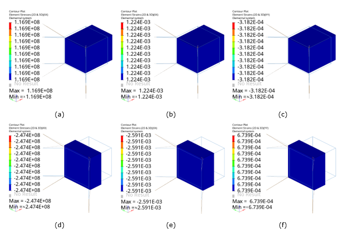

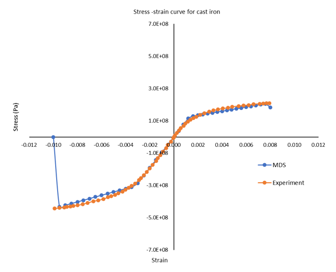

Single-scale Results
Sample cards are generated for Multiscale Designer-OptiStruct integration, with the results of tension and compression test in OptiStruct with the user-defined material.
Elastic properties from homogenization and stress-strain curve from damage law are presented.
- Tensile Young’s modulus (GPa),
- 95.5
- Compressive Young’s modulus (GPa),
- 95.5
- Poisson's value,
- 0.26
Nonlinear Material Characterization
Multiscale Designer-OptiStruct Integration
Structural Analysis

Unidirectional fiber-reinforced polymer composite is subjected to tensile load in fiber-axial and fiber-transverse directions. The response of the material is output and validated with experimental data. The first two sections explain the input data required from the Multiscale Designer (MDS). The next two sections explain the procedure to integrate the material in OptiStruct (OS).
Unit Cell Model and Linear Material Characterization
The matrix is modeled with homogeneous elastic properties and the fiber is assumed to be transversely isotropic. Periodic boundary conditions are applied to the unit cell to obtain the homogenized stiffness matrix of the composite.

For nonlinear material characterization in fiber-axial and fiber-transverse direction, two laminate layups with unit thickness are created with orientations 0° and 90°, respectively. Each laminate is subjected to Unnotched Tensile/Compression macro simulation with different loading rates.
- Loading rate – Fiber axial direction test (/s)
- 0.05
- Maximum strain - Fiber axial direction test
- 0.05
- Loading rate – Fiber transverse direction test (/s)
- 0.017
- Maximum strain - Fiber transverse direction test
- 0.017

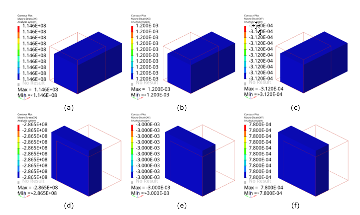

The output data files are generated in the material model directory and the stress-strain curve data will export to an Excel spreadsheet file in <material_model_directory\model_name\mechanical\model_name_NLmatl.xlsx>.

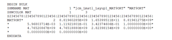

Integrate Multiscale Designer Files with Multiscale Designer-OptiStruct
- In Multiscale Designer solver interface for OptiStruct, click the Homogenized Materials tab.
- Set the card images to MAT2, MAT8, MAT9 or MAT9ORT.
- Click the Multiscale Materials tab and set the output file path for the OptiStruct plugin “dll”.
In the multiscale material data file, browse the file path to
<material_model_directory\model_name\mechanical\model_name_mdsMAT.dat>.
The number of user-defined variables computed for orthotropic damage law is 8, which involves the terms from the damage state variable, equivalent strain, total strain, and eigen strain.
- By default, the OptiStruct plugin data files are output to <material_model_directory\Macro\Mechanical\optiStruct_plugin_data.fem>.
Multiscale Results
Sample cards are generated for Multiscale Designer-OptiStruct integration with OptiStruct test results.
- Longitudinal Young’s modulus (GPa),
- 165.4
- Transverse Young’s modulus (GPa),
- 8.8
- Longitudinal Poisson’s ratio,
- 0.11
- Transverse Poisson’s ratio,
- 0.34
