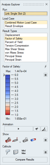

Click the Show Motion Analysis Results tool on the
Analyze Part icon.
Tip: To find and open a tool, press Ctrl+F. For more information, see Find and Search for Tools.The Analysis Explorer is displayed. - Select the Run you want to view.
- Select a Load Case.
- Select the Result Type you want to view.
- Use the additional options to animate the result, change what is shown in the modeling view, create callouts, and compare results.
- Right-click or press Esc to close the Analysis Explorer and return to the original part.

Add Callouts to the Results
Call out and review values for a selected result type at points of interest on your model using the callout icons in the Analysis Explorer.
- Select the Show Analysis Results tool on the Analyze icon, if not already active.
To create a callout at a point of interest, click
in the Analysis Explorer, select a Result Type, and then click a point on your model. Box-select to see the maximum value in an area.
Note: The callout value applies to the currently selected run and load case. -

Compare Results
Compare the results of multiple analysis runs in a table. The Compare Results button is located at the bottom of the Analysis Explorer.
For analysis, you can compare results across all runs and load cases for the selected result type. You can also compare result types at a point of interest where you have placed a callout.
not already active.On the Motion
ribbon, select the Review Flexible Body Results
tool.
Tip: To find and open a tool, press Ctrl+F. For more information, see Find and Search for Tools. -
Click the Compare Results button located at the bottom
The table for comparing results appears at the bottom of the modeling window. -
Select the row to display the results for that run and load case.
- Double-click a cell in the table to show that result in the modeling window.
- Click the chevron next to the table title to select a different result type or a callout.
- Click the chevron on a column header to filter results.
- Click a column header to sort the column.
- Right-click a column header to change what result types, run parameters, or callouts are shown in the table.
- Click the top left corner of the table to copy the contents of all cells. This can then be pasted into Excel.
Additional columns can be added to show additional result types and parameters from the Run Analysis window. The red-blue color bands correspond to the legend in the Analysis Explorer; the width of the band indicates the magnitude of the result. Changes to the upper and lower bound in the Analysis Explorer are automatically reflected in the Compare Analysis Results table.
