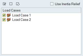

If you have created multiple load cases, click the
button next to Load cases and then select the checkbox next to each load case you want to analyze. Each load case will produce a different result.

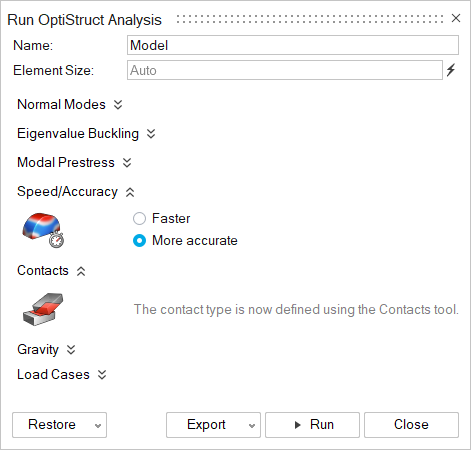

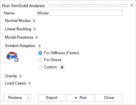

Use the options on the Run Analysis window to define your analysis. Options vary based on whether the SimSolid or OptiStruct solver has been selected.
Run SimSolid Analysis | Run OptiStruct Analysis |
Name
When you run an analysis, the name of the run defaults to the name of the model. However, you can assign your own name to the run in the Run Analysis window.Element Size (OptiStruct)
The element size dictates the quality of your optimization results. In general, the smaller the element size, the more accurate the result, but the slower it will run.
The element size is calculated from the smallest features in the CAD. Cleaning up the CAD so there are fewer features will help jobs to run faster.
Normal Modes
You can choose whether or not to include normal modes, and how many, in your analysis. The results show the shape of the vibration at that frequency. You may also select whether to include supports from a particular load case in the drop-down menu.Buckling Modes (Linear Buckling or Eingenvalue Buckling)
Buckling modes are used to predict when a part will bend or collapse under load. You may select the number of modes and which buckling load cases to include. The resulting buckling load factors help you determine the load required to cause your part to buckle. If the value is in-between -1 and 1 buckling is expected for the given load.Solution Adaption (SimSolid)
SimSolid provides three solution adaption objectives to control solution accuracy.
- Select For Stiffness (Faster) for general load path prediction and modes. This uses three adaptive solution passes and is typically the fastest solution method.
- Select For Stress for more detailed stress calculation. This uses four adaptive passes and activates additional logic to more accurately refine the solution in areas of high stress.
- Select Custom to choose your own custom settings in the Preferences.

Speed/Accuracy (OptiStruct)
Select Faster when stresses are not a major concern and testing your model to ensure that the kinematics of your loads and supports are correct. If you need more accurate results, select More accurate and rerun the analysis to achieve more precise stress and displacement results. This will also increase the run time. More accurate generates second-order elements.Gravity
If the weight of a structure is a significant portion of the load it is bearing, then you should include gravity when running an analysis. Gravity pulls toward the negative z direction by default, but you can change the direction using the pull-down menu.Load Cases
A load case is a set of loads and supports that act on a model at one time. You can assign loads and supports to specific load cases using the Model Browser or context menu. Then when you run an analysis, you choose which load cases to include in the Run Analysis window.Inertia Relief
Inertia relief allows the simulation of unsupported structures. Typical applications are an airplane in flight, suspension parts of a car, or a satellite in space. With inertia relief, the applied loads are balanced by a set of translational and rotational accelerations. These accelerations provide body forces, distributed over the structure in such a way that the sum total of the applied forces on the structure is zeroExport a FEM File
