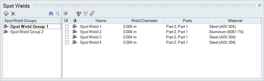

Spot Welds Table
The Spot Welds table lists all of the spot welds in your model. It can be used to change the weld diameter and assigned material or to import/export designated spot weld points in .csv format.
You can also use the table to create and organize spots welds into weld groups. Click
the satellite icon on the Spot Welds tool to display the
table.
The table data can be edited with the following actions:
To | Do this |
Rename a spot weld | Select the cell in the table and then click again to make the field editable. |
Change the material | Select the cell in the table and then select a different option from the list. |
Sort a column | Click the column header. Click repeatedly to toggle between ascending and descending order. |
Add or remove columns | Right-click on a column header. |
Create a spot weld group | Click the ![]() |
Move a spot weld to a different group | Select the check box next to the spot weld, then right-click and select Move to... from the context menu. |
Import points where spot welds will be created automatically | First, create a .csv file following the template.
Export points where spot welds are located in the model |
