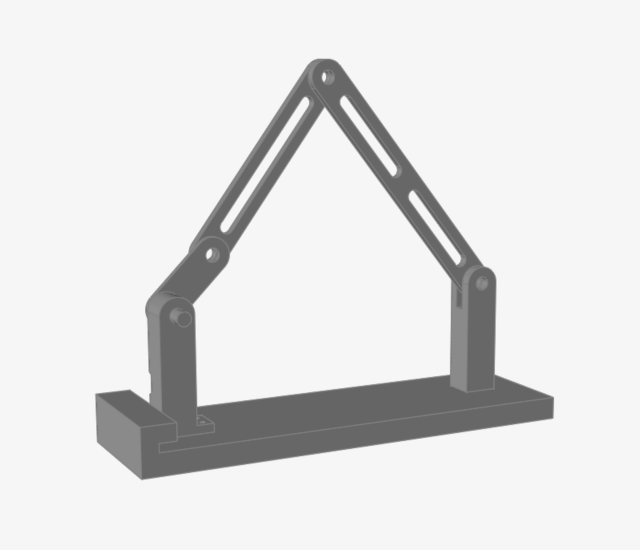

Open the CAD model
- Press F7 to open the Demo Browser.
Double-click the M01_FourBar.x_t file in the Motion folder
to load it in the modeling window.

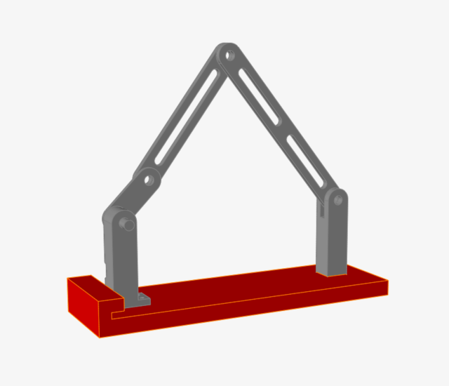

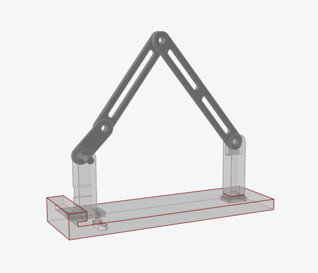

Ground a Part
On the Motion ribbon, select the
Ground tool from the Connections category.
Tip: To find and open a tool, press Ctrl+F. For more information, see Find and Search for Tools. -
Select the Base part to ground it.
The part turns red, and the part icon in the Model Browser
changes to indicate that it is a ground part.

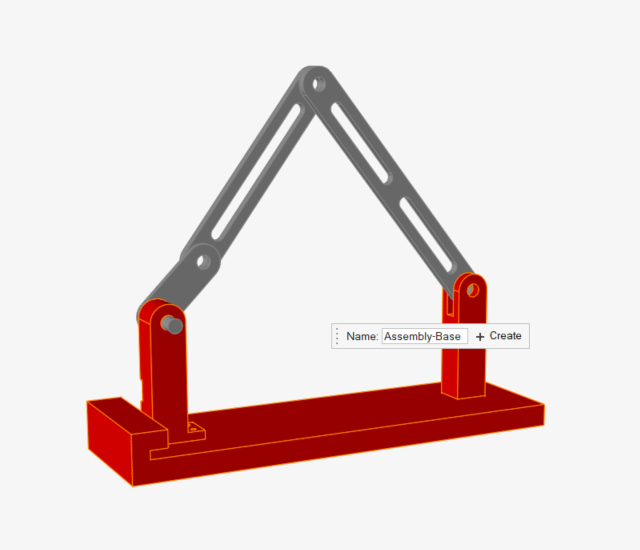

Create a Rigid Group
Select the Rigid Groups tool.
Select the Base, Mount Crank, and
Mount Clevis parts in the bottom half of the
mechanism.
The parts turn red as you select them.
Click the floating Create New Group icon to place the
parts you selected into a new rigid group.

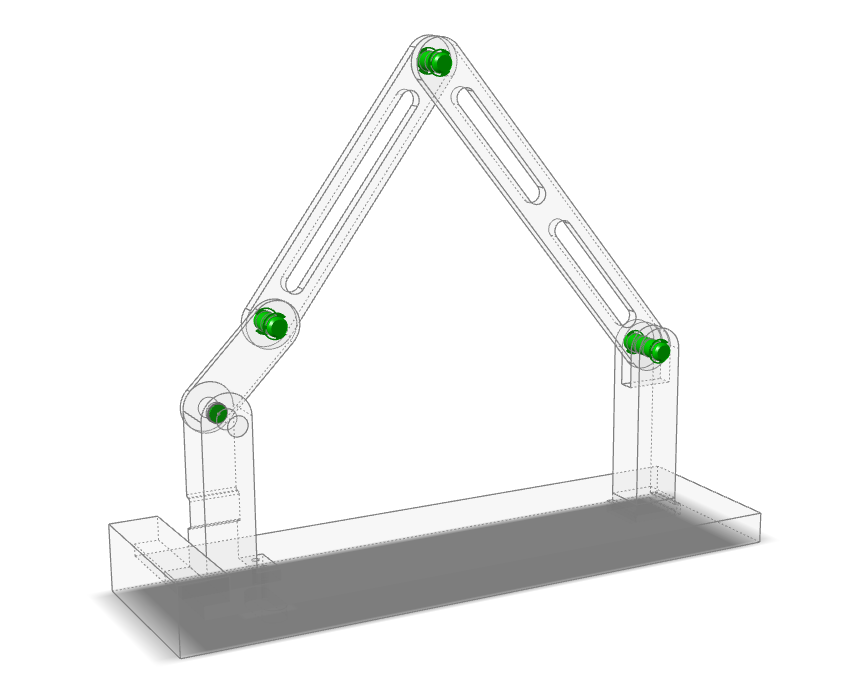

Connect Parts with Joints
Select the Joints tool.
- Check that the guide bar is set to the default settings (All Parts, All, Auto).
Click
, then the
button.
Joints are created at neighboring parts in the model. The colors indicate the joint state (in this case all have been set to Active).

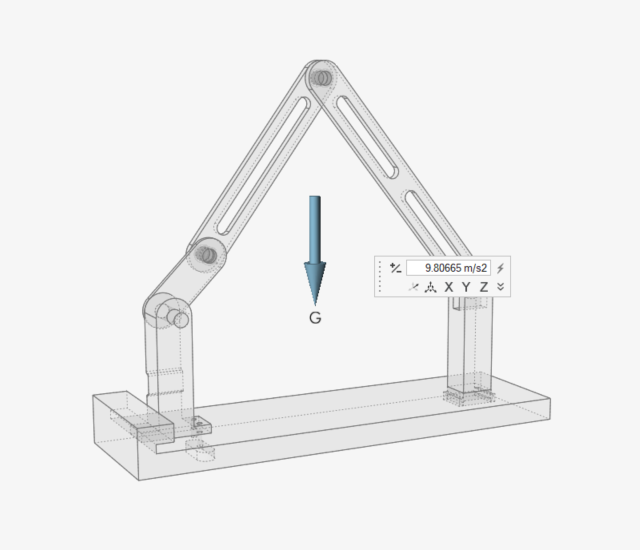

Inspect the Gravity Direction
Open the Gravity tool:
Notice that a vector is displayed which indicates the direction of
gravity.

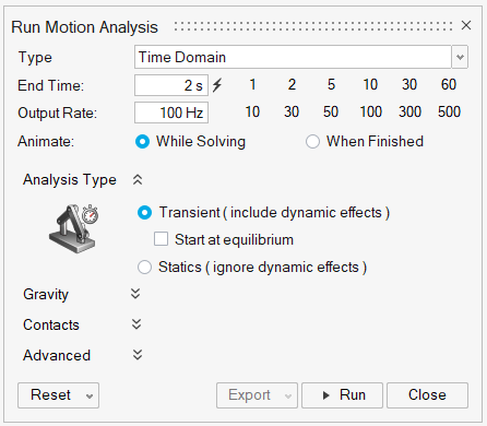

Change the Run Settings and Rerun the Analysis
Hover over the Analyze Motion tool, then click the
Run Settings icon to open the Run Motion Analysis
window.
- Change the Output Rate to 100 by entering the value in the field or clicking the 100 button.
Click Gravity and verify that it is set to
Yes.
This is the default setting for a motion analysis.
- Close the Run Motion Analysis window.

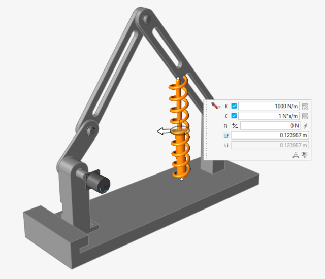

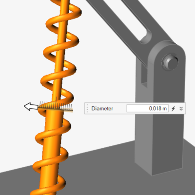

Add a Spring-Damper Force
Select the Coil Spring tool on the Springs icon.
Click the Mid (middle) snap point of the Link Dual Slot
part.
The selected feature turns red.
Select the Base part.
A coil spring appears and the microdialog shows the default settings.
Click and drag the end point manipulator at the bottom of the spring to
relocate it to the Mid snap point of the Base part.
In the microdialog, change the K stiffness value to
2500 N/m.
Click and drag the white arrow manipulator to reduce the spring Diameter
slightly.
Click the Run Settings icon.
Change the End Time to 2 s by entering the value in the
field or clicking the 2 button.
- Close the window.
