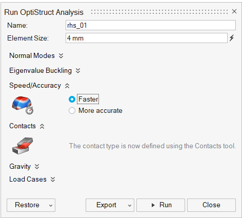

Click the
button on the Analyze icon to set up an analysis using the following options.
- Set the Element size to 4 mm and the Speed/Accuracy to Faster.
- Click Run and note the speed of execution. If this was modeled as a solid, the run time would increase by an order of magnitude or more to achieve similar accuracy in the results.

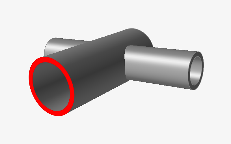

Select the Patch tool on the Geometry ribbon.
Tip: To find and open a tool, press Ctrl+F. For more information, see Find and Search for Tools. -
Click the face on the end of one of the tubes to select it.
You may need to zoom in to select the face.
Click again to delete the face.
As soon as it is deleted, the solid part becomes a surface, and an area rather than a volume is shown in the Property Editor.
Use the same process to remove the remaining three faces from the ends of the
tubes, as well as all of the interior surfaces.

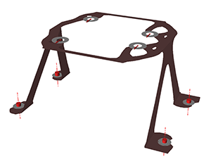

Open the 2dtopology_and_contact.stmod file from the Demo
Browser.
This model contains both geometry and loads.
Select the Tray part and enter a
Thickness of 3 mm under Mass
Properties in the Property Editor.
- Assign a Thickness of 3 mm to Part 1 and Part 2 as well.
Right-click on the Tray part to open the part context
menu and designate it as a Design Space.
Open the Symmetric Controls tool:
On the Structure ribbon, select the
Add/Edit Symmetric Controls tool.
Select the Symmetric tool from the secondary
ribbon.
Select the Tray part to apply a symmetry plane as
shown:
Click the
button on the Optimize icon to set up an optimization with a Mass Target of 25% and a Minimum Thickness Constraint of 15 mm:
