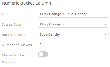

  3. Select the numeric Source Column.
  4. Select EqualDensity in the Bucketing Mode drop-down list box.
  5. Enter the Number of Buckets. This value can be parameterized.

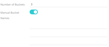

  6. Tap the Manual Bucket slider to turn it on.
    The Names text box is enabled. For this example, 3 text boxes are available based on the specified Number of Buckets in step 5.
  7. Enter the bucket Names.

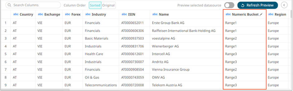

  8. Click  . The new numeric equal density bucket column is added and displayed in the Data Preview.
    For this example, the minimum value of the Source Column (1 Day Change %) is -0.35 and the maximum value is 0.12. When there are three buckets the ranges will be:
    • Range1: -0.11, -0.03
    • Range2: -0.03, -0.01
    • Range3: -0.01, 0.09

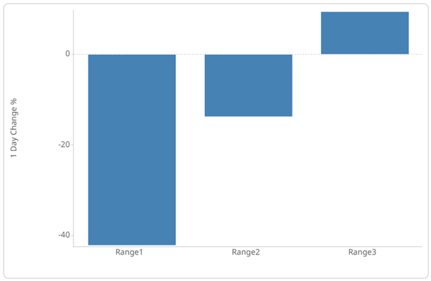

    This can then be used in a visualizations breakdown to display data samples.
