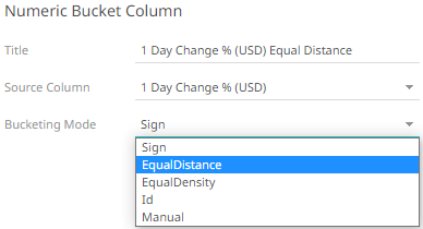

- Select the numeric Source Column.

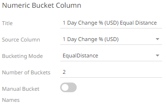

- Select Equal Distance in the Bucketing Mode drop-down list box.
- Enter the Number of Buckets. This value can be parameterized.

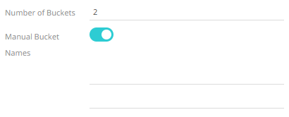

- Tap the Manual Bucket slider to turn it on.
The Names text box is enabled. For this example, 2 text boxes are available based on the specified Number of Buckets in step 5.
- Enter the bucket Names.

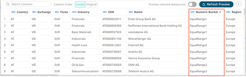

- Click
. The new numeric equal distance bucket column is added and displayed in the Data Preview.

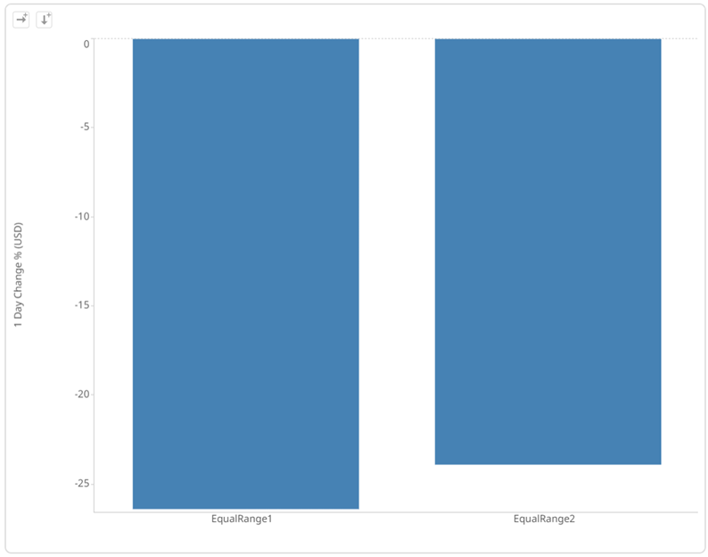

This new user defined column can be used in a visualizations breakdown to display data samples.
