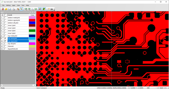

XOR
- XOR, only the wrong part of both Gerber files displays on the screen.
Figure 5. - Layer selection you want to compare
- Right-click on the list > .
Merge
Figure 6.
