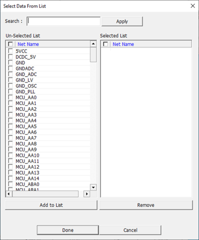

- Nets: Selecting the nets. You can select target nets with the net name.
- Net Name Filter: Use the net name filtering box to select nets and add them to the item list.
- Net Name: The following image describes component selection with the
reference name.
Figure 1. - Net lists shown in design.
- Un-Selected List: The selected items.
- Selected List: Move the selected item to the Selected List item.
- Remove: Delete the item in the Selected List.
- Search: Net name searching menu.
- You can search the keyword using the wild card *, ?, #, and “”. The keyword
search is case-insensitive. The search list will automatically update as you
enter the keywords.
- *: perform a multiple character wild card search (String)
- ?: perform a single character wild card search (One Character)
- #: perform single character wild card search (One Number)
- " ": perform search matching the string
A*: Net name starting with string A.
*B: Net name ending with string B.
A*B: Net name string starting with A and ending with B.

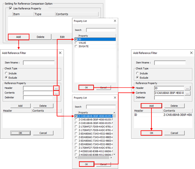

- Setting for Reference Comparison Option
- Use Reference Property: Activate or deactivate the checkbox for components
during component comparing. You can decide to checking or un-check certain
components (reference designator) that have specified properties. Click
Add to open the filter window.
