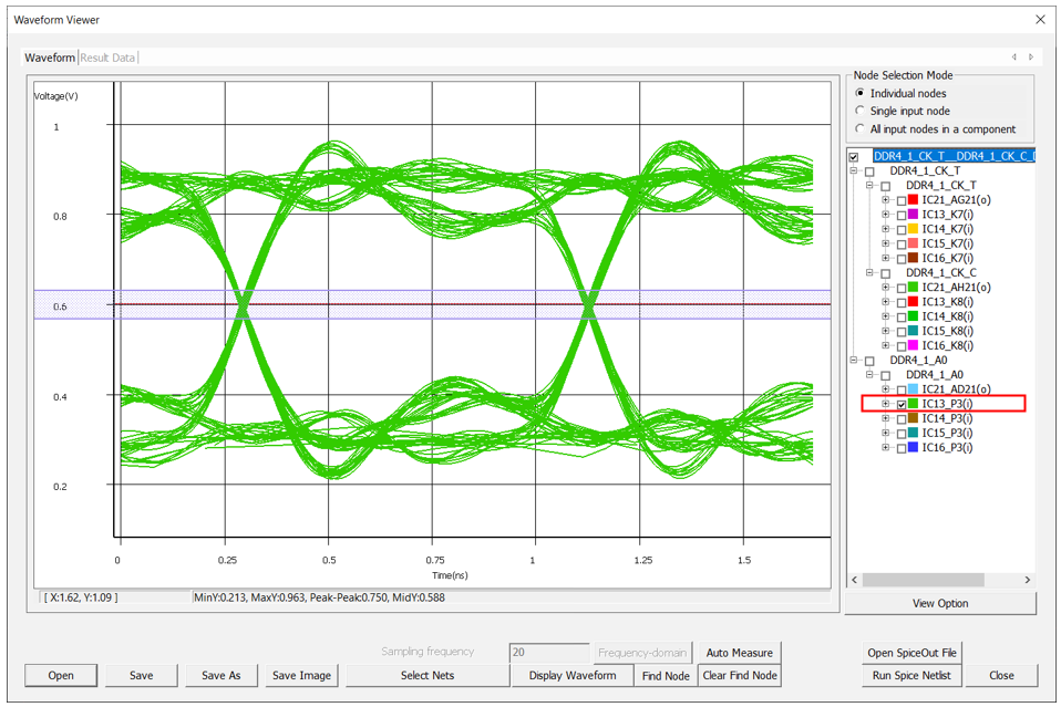

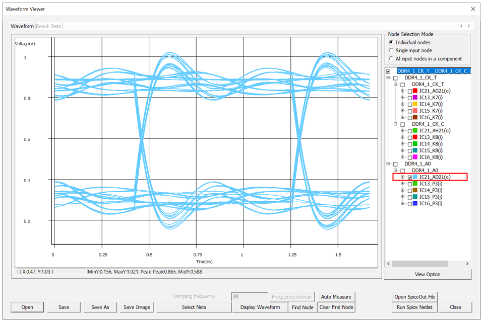

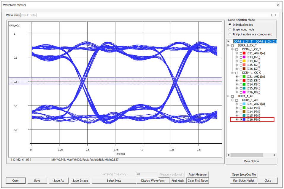

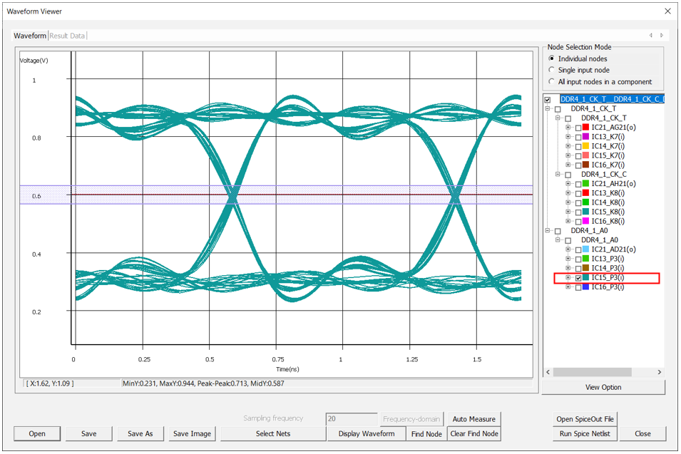

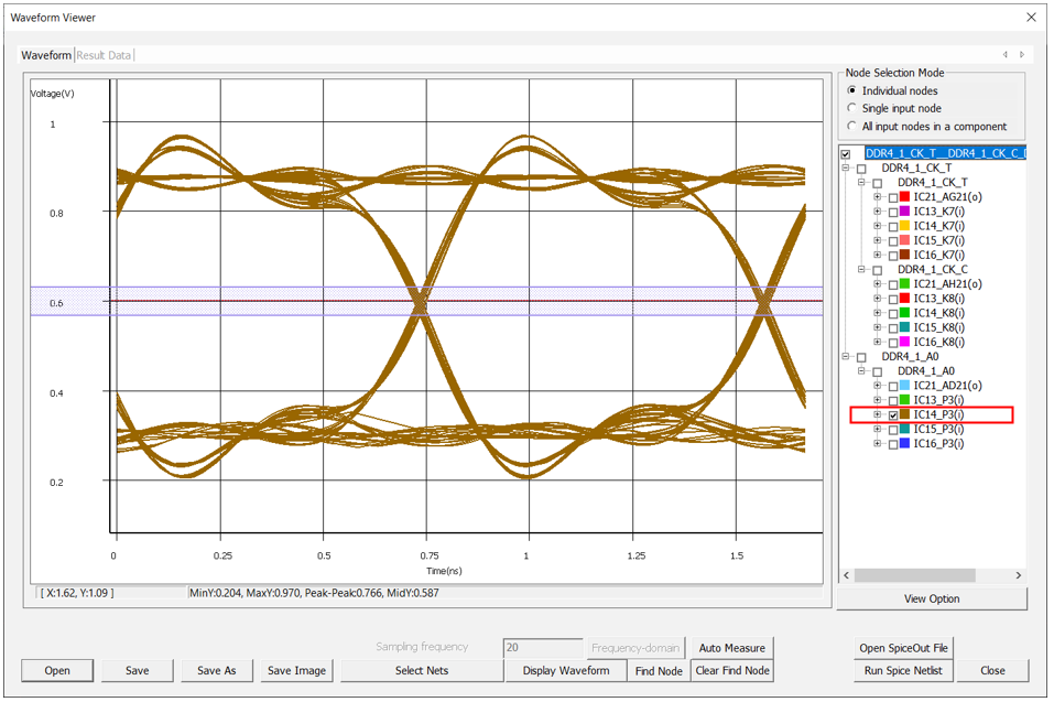

- Individual nodes - This mode is used when a user wants to view one waveform
each for address or data lines, excluding the clock signal (Reference). For
example, the following are the example of viewing each of the five A0 lines separately.
Figure 5.
Figure 6.
Figure 7.
Figure 8.

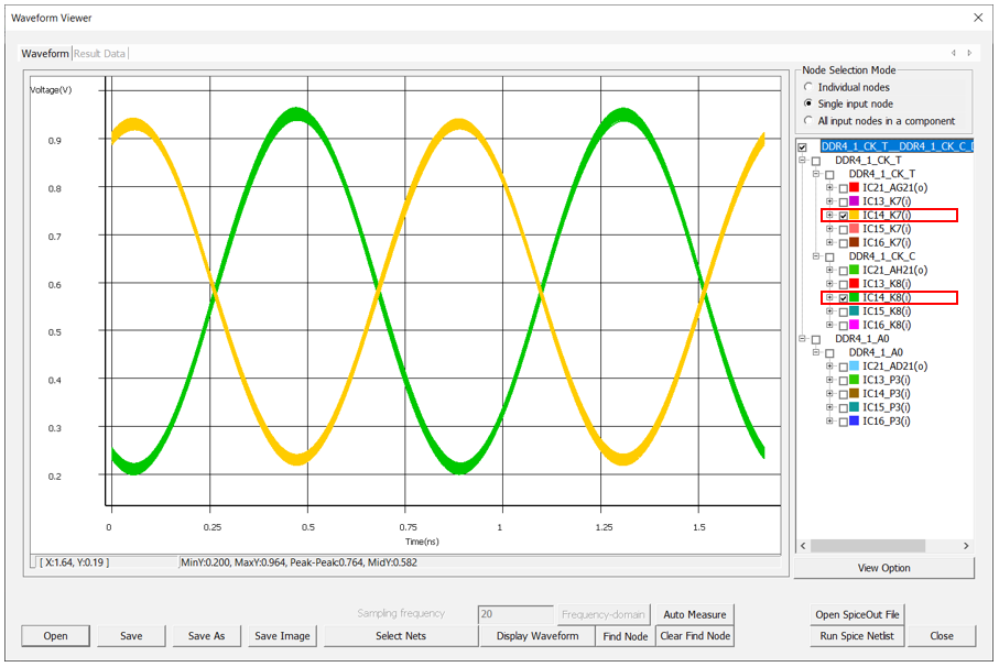

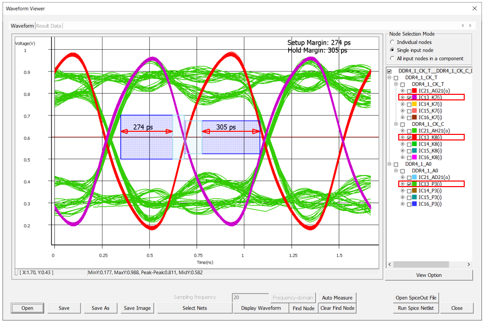

Figure 9. - Single input node - This mode is used when a user wants to view only the
plus and minus pairs of the clock signal and it displays two waveforms.
Input nodes include IC13_K7(i), IC14_K7(i), IC15_K7(i), IC16_K7(i) and
IC13_K8(i), IC14_K8(i), IC15_K8(i), and IC16_K8(i) that are DDR memory
side. For instance, clicking on IC14_K7(i) of the Clock automatically
selects IC14_K8(i) as below. They are a pair.
Figure 10. - All input nodes in a component - This mode displays both the address and the
plus/minus pairs of the clock signal simultaneously showing three waveforms.
For example, clicking on IC13_P3(i) of the Address automatically selects
IC13_K7(i) and IC13_K8(i) of the clock. Selecting IC13_K7(i) of the Clock
will also automatically choose IC13_P3(i) of the Address and IC13_K8(i) of
the clock.
