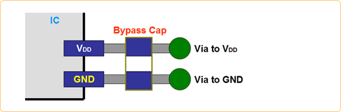

- Decoupling Capacitor (Decap) This capacitor is connected to the IC component’s power pin. At the time of a sudden surge of power consumption or during rising/falling time, it supplies a stable power to IC components. It is used mainly in high speed signal circuits.
- Bypass Capacitor This capacitor is used to reduce power noise. A bigger
capacitance capacitor is used for lower frequencies. A smaller capacitance
capacitor is used for higher frequencies.
Decoupling Capacitor Usage on Multi-Layer Board
Figure 3.
Bypass Capacitor Usage on Multi-Layer Board
- Advantage: Lower number of capacitors is required since some VDD-GND pairs can share one capacitor.
- Disadvantage: Larger current loops compared to pin-decoupling.
