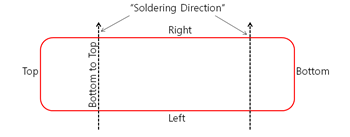

- Board Direction Definition: Decide the board's placement status using the
soldering mark or by defining the soldering direction.

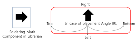

- Soldering-Mark Component Group: Define the soldering mark. Use if it is registered as a group of components.
- Mark Direction: Define the mark’s direction and the soldering
direction.
Figure 1. - Soldering Direction: Define the direction of the board without using
soldering-mark case.

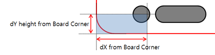

- Guide Hole Searching Ranges from Board Corner: Set the area where the
guiding hole is located. Specify area values with dX and dY from the board
corners. Refer to Figure 4.

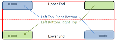

- Diagonal Counting: Verify the number of guide holes in the
diagonal sides.
- Left Top, Right Bottom: Set the number of guide holes in these regions.
- Right Top, Left Bottom: Set the number of guide holes in these regions.

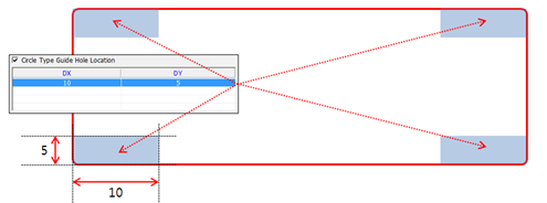

- Circle Type Guide Hole Location: Verify the guide holes in each
board corner. The table rows each correspond with the four corners
of the PCB.

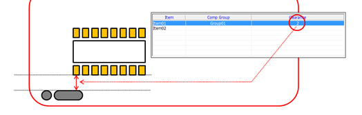

- Clearance between Guide Hole and Components
- Clearance Table: Set and assign a clearance value for the component
group. Use PollEx DFM to verify the
clearance between the component outline and the guide hole edge.
Figure 11. Clearance Table Example - Remainder: Assign a clearance value for the undefined components in the table.
