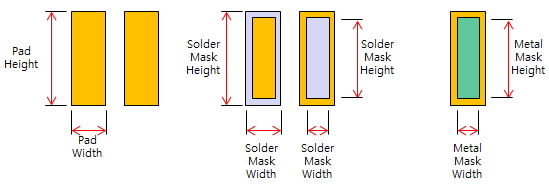

- Pad Size and Pin Pitch Checking: Check components pin pitch and pad
size.
- Item: Specify the item name.
- Component Group: Double-click the column and select the component group from the group list dialog.
- Layer: Specify the target layer.
- Pin Pitch: Set the pin pitch using the floating value ranges input tool.
- FPCB Area: Option to check the Pad Size in the FPCB area.
- Pad Width: Set the pad width using floating value ranges input tool.
- Pad Height: Set the pad height using floating value ranges input tool.
- Solder Mask Width: Set the solder mask width using floating value ranges input tool.
- Solder Mask Height: Set the solder mask height using floating value ranges input tool.
- Metal Mask Width: Set the metal mask width using floating value ranges input tool.
- Metal Mask Height: Set the metal mask height using floating value
ranges input tool.
