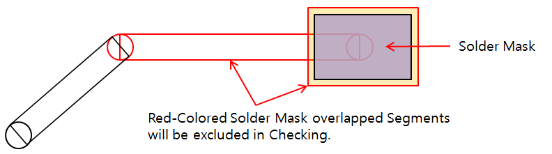

- Attribute (For Exception): Among target objects, objects with certain properties will be excluded in checking. Upon double-clicking column, the properties list will appear. Among properties, select properties, to be used for exception for objects.
- SR Open (For Exception): If target objects overlap with given solder
mask layer’s object, they will be excluded in checking.
