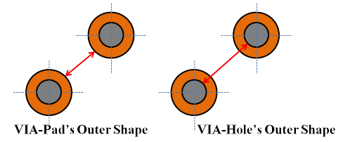

- Measure Base: Select one of two items between pad shape and hole
shape. This will be used to measure the clearance from other objects
to via.
Figure 1.- Pad Shape: Via pad outer shape will be used as via boundary.
- Hole Shape: Via hole will be used as via boundary.
