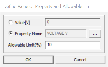

- Working Voltage
Check: Set the allowable working voltage of this component. You can set this
by entering the allowable value directly or select the property name which
contain allowable working voltage value. You can also assign tolerance of
this check.

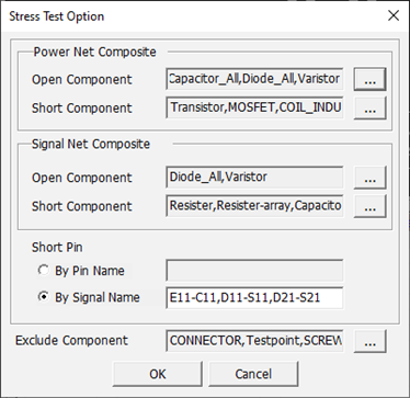

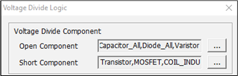

Stress Test Option
Set whether passive components are considered short or open when navigating signals and power lines.
