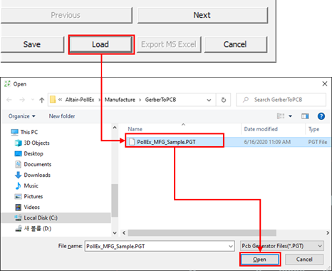

From the menu bar, click Manufacture > Gerber to PCB > ODB++.
Click Load and select the
PollEx_MFG_Sample.pgt file from
C:\ProgramData\altair\PollEx\<version>\Examples\MFG\GerberToPCB.
Click Open.
Click Next.

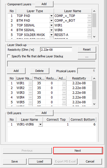

The pre-defined PCB Generator Files sets the Component Layers and Drill
Layers. Figure 2.

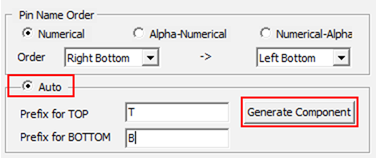

Make component.
Select Auto.
For Prefix for TOP, enter T.
For Prefix for BOTTOM, enter B.

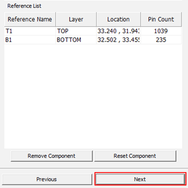

Click Generate Component.
The components are automatically generated. Figure 3.
The generated lists for the TOP and BOTTOM are displayed in the
Reference List.
Click Next.

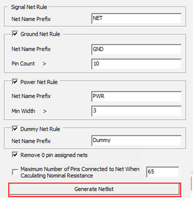

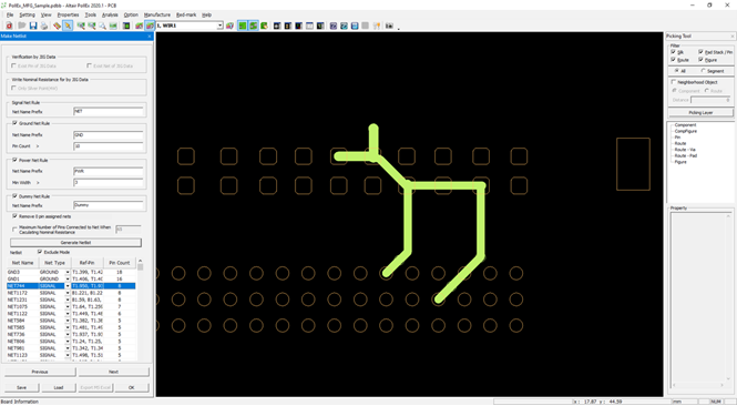

Make Netlist.
Under Signal Net Rule, enter NET for Net Name
Prefix.
Under Ground Net Rule, enter GND for Net Name
Prefix.
Under Power Net Rule, enter PWR for Net Name
Prefix.
Under Dummy Net Rule, enter Dummy for Net Name
Prefix.
Enable the Remove 0 pin assigned nets
checkbox.
Disable the Maximum Number of Pins Connected to Net When
Calculating Nominal Resistance checkbox.

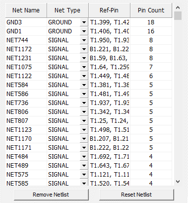

Click Generate Netlist.
Figure 5.

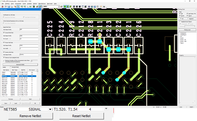

The created Netlists are displayed in the table. Figure 6.
Click NET744.
The selected net is highlighted in the design. Figure 7.
Enable the Exclude Mode checkbox.
Only the selected net is displayed. Figure 8.

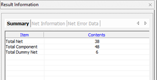

Review result information.
The result is displayed in each category such as: Summary, Net Information,
Net Topology Information, and Nominal Resistance. Figure 9.

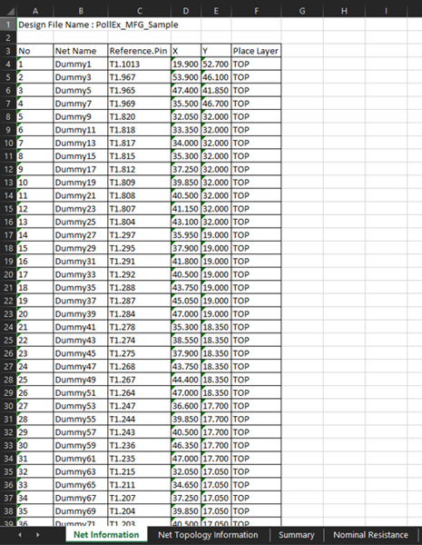

Export the result.
The result can be exported to Excel format.
Click Export MS Excel.
Figure 10. Figure 11.

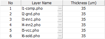

Define Layer Stack-up.
Click Add six times.
For 1, select l1-comp.pho for Layer Name.
For 2, select l2-gnd.pho for Layer Name.
For 3, select l3-inn1.pho for Layer Name.
For 4, select l4-inn2.pho for Layer Name.
For 5, select l5-vcc.pho for Layer Name.
For 6, select l6-sold.pho for Layer Name.
Figure 13.

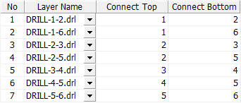

Define Drill Layers.
Click Add seven times.
Select layer names and enter the Connect Top and Connect Bottom values
as shown in Figure 14.
Figure 14.

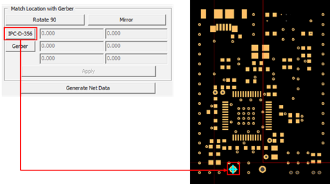

Match the Location of Gerber and IPC data.
Click IPC-D-356.
Click the component in the IPC data.
Figure 16.
Click Gerber.
Click the component in the Gerber data.
Figure 17.
