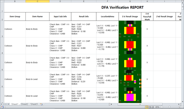

Excel export of DFA verification result.
From the menu bar, click Export > User Defined Excel Format to execute the wizard.
Click Load and select the
PollEx_DFA.DFAE file from
C:\ProgramData\altair\PollEx\<version>\Examples\Verification\DFA\DFAE.
